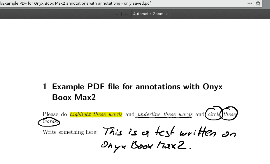

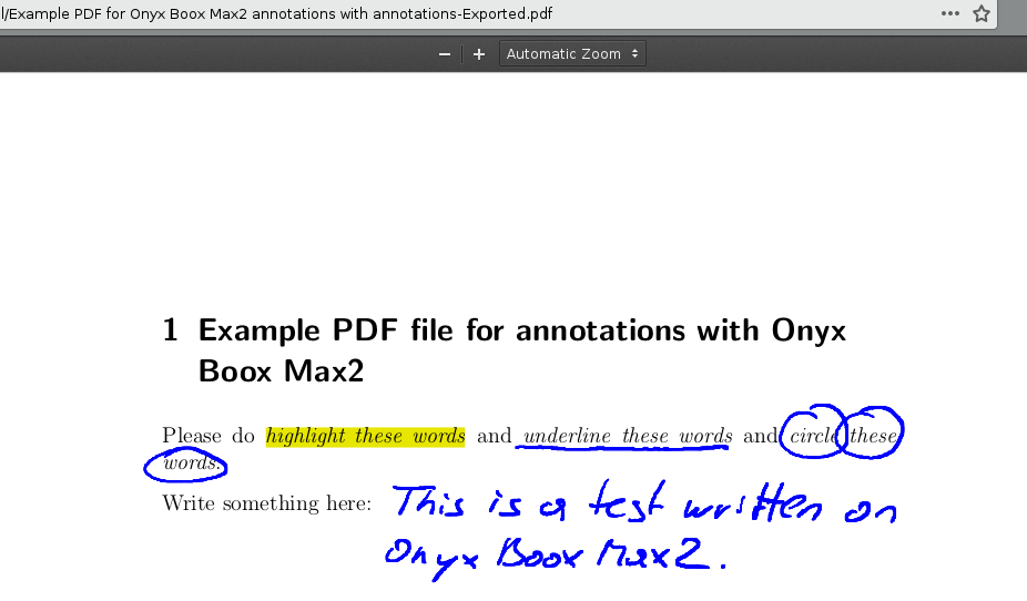

I've created a minimal example document demonstrating my issue.
The source is a LaTeX document which I compiled with pdfLaTeX to a PDF.
Then I was using the PDF embed and the save method to generate two PDF files that contain my annotations.
A couple of screenshots show how the files are displayed on my Debian system. The Okular screenshots also show the STDOUT output of the console.
