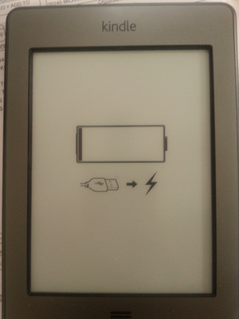

Hi everybody, my kindle does not start, the screen show a discharged battery but it is fully charged. I tried to reset holding the power button, I tried with kubrick 3.6 but the kindle does not enter in fastboot mode, I tried with MFGTool but nothing worked. What can I do ?
Thank's a lot.
P.S. in attachment the pictures of the screen

It's plainly not fully charged. Connect it to a wall charger (not a PC), and leave it overnight. If it's still like that in the morning, you probably have a dead battery.
I charged it for 3 days using a wall charger. I opened and I measured the voltage of the battery and is 3,75 volts. Seems to be fully charged.

In that case it sounds as if the power isn't getting from the battery to the main circuit board. Another possibility is that the screen has died, and it's simply displaying the image it had on it before it died.
Either way, I strongly suspect a hardware problem. I don't know if anyone else has any other suggestions?

If you think you have fully charged your battery - have you tried resetting it? (Hold the button off for 20seconds - time it with a watch to make sure you do it long enough). It will take a minute or so to reboot
When I have allowed my touch to discharge fully (when I have been using another device). The device was stuck like this so I had to reset it.

I had this same screen yesterday, and after charging all day, it still appeared to be frozen. After trying to reset a couple times, finally held for the 20 seconds or more to do a full reboot and it is now working fine. I also had a bunch of downloads that needed to sync so it took me lots of time for that which didn't help with the reset. Finally shut off wifi before doing a hard reset and all is working well now. Must remember to never let the battery get that low again on any of my kindles.
