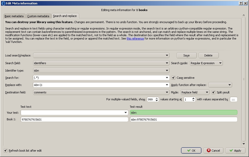

  1. Select all the books you wish to affect, and open Bulk Metadata Edit. Make sure you are using regex mode.
  2. Search for...
    Search field: identifiers
    Identifier type: isbn
    Search for: (.*)
    Replace with: \1
    Destination field: <anything you can spare. I used "comments">
    Apply the edit.
  3. Search for...
    Search field: comments
    Search for: (.*)
    Replace with: isbn:\1
    Destination field: identifiers
    Identifier type: *
    Apply the edit.
The reason this works is because, while there is no way to replace an identifier with a subset of itself, you can use * to replace all the identifiers IF AND ONLY IF the search field is not "identifiers". So by temporarily storing the isbn in another field, you can have the isbn overwrite the whole identifiers field.
(I used the comments field, because I used a test book created by importing another book from the same library. )
See screenshots.

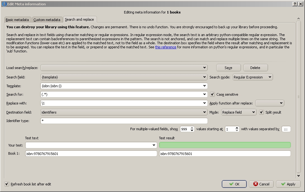

A better way would be to use chaley's method, which I would've recommended if I knew it existed.
Search field: {template}         (YES! This exists and it is awesome!)
Template: {isbn:|isbn:|}
Search for: (.*)
	>> Mode: Replace field, Split Result="checked"
Identifier type: *
Template uses isbn # and prepends "isbn:" to it, then feeds that into the replace. No need for a custom column at all. Thanks chaley!!

Thanks, that works fine. (I did change the "Replace with" so it agrees with your screen snap:
Replace with: \n
Without this change the string "isbn:" is duplicated.
