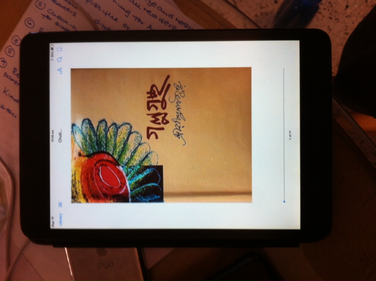

Hi all...
I know the issue of svg wrapper code for cover images has been done to death but I'm having a bit of a problem and after several hours of going through posts, I decided to ask for help!
I'm creating an epub for iPad only. My image dimensions are 600 X 800. I've copy-pasted the svg wrapper code into my Front Cover xhtml file and changed the dimensions to that of my image. Unfortunately, the image is not resizing to fill the page. More specifically, its fine for top, left and right but not the bottom. I've attached an image for your reference.
For test purposes I resized my actual image to 489 X 751 (an image size from someone else's working epub) and it worked fine.
I was wondering if there's a glitch with image dimensions and iBooks or if anyone else has faced this problem...
Any ideas would be sincerely appreciated!
Thanks in advance
Nabodita

If you implemented the SVG wrapper correctly, the aspect ratio is maintained. If the aspect ratio of the image differs from the ratio of the screen, you will get margins.
The SVG-wrapper (if you are using the "standard" one) does not work to fill the page, but to show the entire image - whatever the screen area available - at the correct aspect/ratio and without cutting anything.
600 X 800 is - well - 600 X 800, translating 489 X 751 to the same ratio gives you 600 X 921, which is why it fills the ipad screen better
I don't know if this sounds clear - but I think there are a guide somewhere to ipad/ibook specs.

Oh. Duh.
Yes, I used the standard code. For the preserve aspect ratio, I used 'xMidYMid meet'. If I set this to 'none', will it distort and fill the screen?
Also, is there any way to center the image on the screen so that the margins on each side are equal - that way, I can get away with using my 600 X 800 image. Otherwise, what original aspect ratio should I be aiming for for my image?
Before I tried the svg wrapper code, I was using a simple <img> tag inside a <div> for the cover, and iBooks displayed it exactly the same.
Ok, bottomline. I need the image to fill the screen as much as possible. I will resize the image if I need to. So what would be the best way of achieving this?
Thanks
Nabodita
Update: Set preserve aspect ratio to 'none' for my 600 X 800 image and got the same result as with 'xMidYMid meet'. Still looks the same as the pic I attached in the first post.

Well, I'm still getting the image centered horizontally but not vertically. That's what I want really. That the image should be centered on the screen while maintaining the aspect ratio. It would be ideal if my image had the same aspect ratio as the screen but I don't know what that should be.
I suppose I should have said that to start with. Darn.
