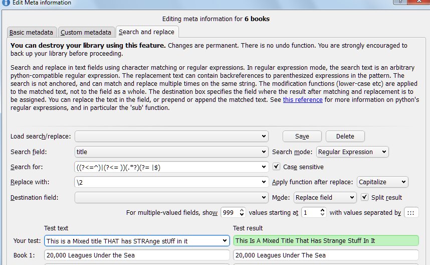

Python regexps don't have replacement target processing like the ones in VI. However, there is a way to do it using calibre's post processing on search/replace. The idea is to find each word one by one then capitalize that word. 'Twas a bit of a challenge to work it out. You can see it in the screen capture of the bulk metadata search and replace I used. The text of the regexp in that capture is
which means look-behind for a space or the beginning of the text, then match as little as possible until a look-ahead for a space or the end of the text succeeds.

Tried "\b(.*?)\b" and "\b(.*)\b", and they don't work. It seems that the first one should, but I didn't feel like taking the time to work it out why it doesn't.
Ahh ..., "\b(\S*)\b" does work, as does "(\S*)".
