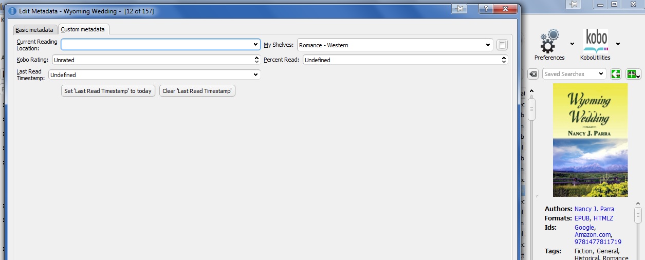

[LIST]
The "Change Reading Status in Device Library" option is the second type. It is enabled when you look at the device list so that you can change the status for books that are not in the calibre library.
The issue is that I have the Glo connected to the computer, Calibre is open, and I'm right clicking on a book that has "Main" in the "On device" column, ... no where can I change the reading status to "finished" ... I'm sure I missed a step ...
I'm attaching (hopefully), screen shots ...
ID:	119155   Click image for larger version
ID:	119156   Click image for larger version

You're in library view. Click on the device icon at the top to switch to device view.
It's possible that you might not see the menu entry for Kobo utilities in device view. If that's the case, head to preferences and select to edit menus, and add Kobo utilities to one of the menus that says it is displayed when a device is connected.
DUH Of course you will see the menu entry in device view! You already ARE seeing it with the device connected. Sorry to be so DENSE!
