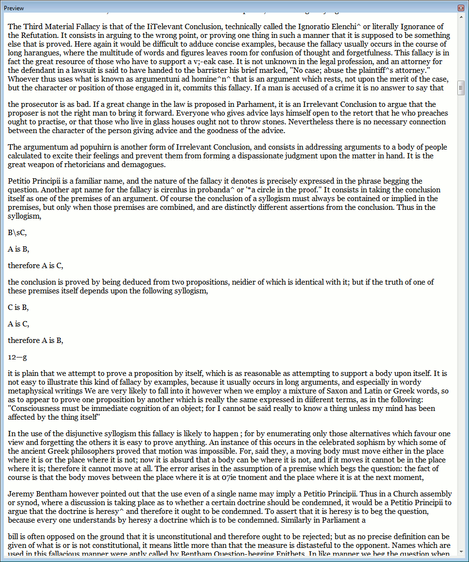

Here is the section in the Archive.org EPUB (this is the OCRed text backend):
Side Note: Keep in mind, this PDF is an example of an old book that is QUITE clean. There are HORRORS out there.
<p>The Third Material Fallacy is that of the IiTelevant Conclusion, technically called the Ignoratio Elenchi^ or literally Ignorance of the Refutation. It consists in arguing to the wrong point, or proving one thing in such a manner that it is supposed to be something else that is proved. Here again it would be difficult to adduce concise examples, because the fallacy usually occurs in the course of long harangues, where the multitude of words and figures leaves room for confusion of thought and forgetfulness. This fallacy is in fact the great resource of those who have to support a v;-eak case. It is not unknown in the legal profession, and an attorney for the defendant in a lawsuit is said to have handed to the barrister his brief marked, "No case; abuse the plaintiff^s attorney." Whoever thus uses what is known as argumentuni ad homine^n^ that is an argument which rests, not upon the merit of the case, but the character or position of those engaged in it, commits this fallacy. If a man is accused of a crime it is no answer to say that</p>
<div class="newpage" id="page-179"></div>
<p>the prosecutor is as bad. If a great change in the law is proposed in Parhament, it is an Irrelevant Conclusion to argue that the proposer is not the right man to bring it forward. Everyone who gives advice lays himself open to the retort that he who preaches ought to practise, or that those who live in glass houses ought not to throw stones. Nevertheless there is no necessary connection between the character of the person giving advice and the goodness of the advice.</p>
<p>The argumentum ad popuhirn is another form of Irrelevant Conclusion, and consists in addressing arguments to a body of people calculated to excite their feelings and prevent them from forming a dispassionate judgment upon the matter in hand. It is the great weapon of rhetoricians and demagogues.</p>
As you can see, the text is "ok" (the formatting is nonexistant, it will be riddled with page numbers/headers/symbols/junk), and I definitely wouldn't want to read an entire book full of those OCR errors!

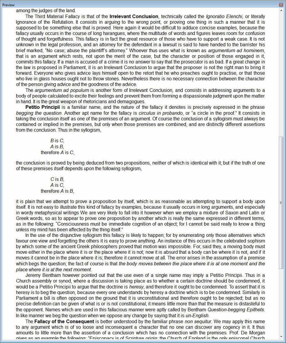

Here is the same section in my EPUB after manual cleaning (EPUB is attached at the bottom of this post):
<p>The Third Material Fallacy is that of the <span class="bold">Irrelevant Conclusion</span>, technically called the <span class="italics">Ignoratio Elenchi</span>, or literally Ignorance of the Refutation. It consists in arguing to the wrong point, or proving one thing in such a manner that it is supposed to be something else that is proved. Here again it would be difficult to adduce concise examples, because the fallacy usually occurs in the course of long harangues, where the multitude of words and figures leaves room for confusion of thought and forgetfulness. This fallacy is in fact the great resource of those who have to support a weak case. It is not unknown in the legal profession, and an attorney for the defendant in a lawsuit is said to have handed to the barrister his brief marked, “No case; abuse the plaintiff’s attorney.” Whoever thus uses what is known as <span class="italics">argumentum ad hominem</span>, that is an argument which rests, not upon the merit of the case, but the character or position of those engaged in it, commits this fallacy. If a man is accused of a crime it is no answer to say that the prosecutor is as bad. If a great change in the law is proposed in Parliament, it is an Irrelevant Conclusion to argue that the proposer is not the right man to bring it forward. Everyone who gives advice lays himself open to the retort that he who preaches ought to practise, or that those who live in glass houses ought not to throw stones. Nevertheless there is no necessary connection between the character of the person giving advice and the goodness of the advice.</p>
<p>The <span class="italics">argumentum ad populum</span> is another form of Irrelevant Conclusion, and consists in addressing arguments to a body of people calculated to excite their feelings and prevent them from forming a dispassionate judgment upon the matter in hand. It is the great weapon of rhetoricians and demagogues.</p>

I personally just use Finereader (A/B compare PDF/OCR) -> Export as EPUB -> Clean the code + add formatting.

Just came from testing lighting and DPI in the university's photo studio. Scanned a few pieces and did the OCR in my comp. Seems to work just fine. As a matter of fact, the OCR showed little to no mistakes.
The book was quite clean: clean characters, clean pages, clean footers and headers. Clean everything.. I'll be returning in a few hours in order to check out the typewriter text and old papers.

The thing that is horrible though is that you cannot rely on Finereader marking things properly (headers/pagenumbers, footers/footnotes).
The actual CODE in the backend making the DOC look close to the actual page is ABSOLUTELY DREADFUL.
You may potentially dig yourself into a hole where you will have to waste lots more future manpower going out from a HORRIBLY designed DOC -> HTML (or whatever other format you want).
Which is why I personally just jump from OCR -> EPUB (barebones HTML), and do my fixing directly. HTML + CSS is not going anywhere... and I keep the code extremely minimal/consistent throughout all my books, which makes it easy as pie to just copy/paste to sites/anywhere.
