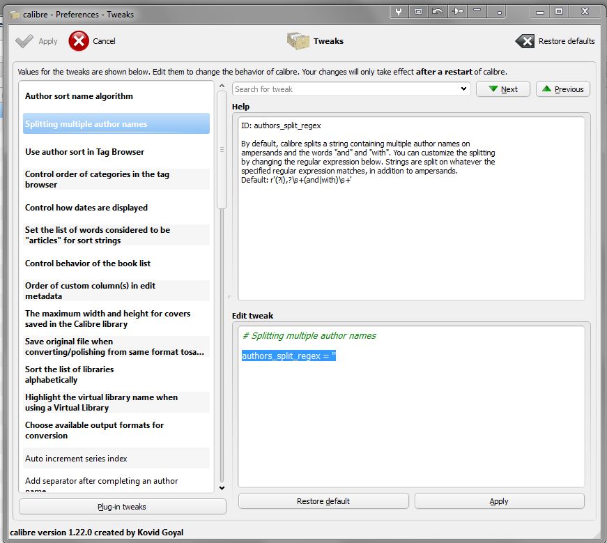

If you 'null' the regular expression in authors_split_regex (see attachment) then that will stop it splitting on 'and' and 'with'. Then you could at least change "Muscle & Fitness" to "Muscle and Fitness" etc
But, as theducks has the reminded us, doing this sort of thing can screw up your other libraries. I think all the Tweaks are global, so you have to remember to adjust them when you switch libraries.
Maybe I should bite the bullet and put my 3 major libraries into separate calibre portable installation folders - weekend job I think
