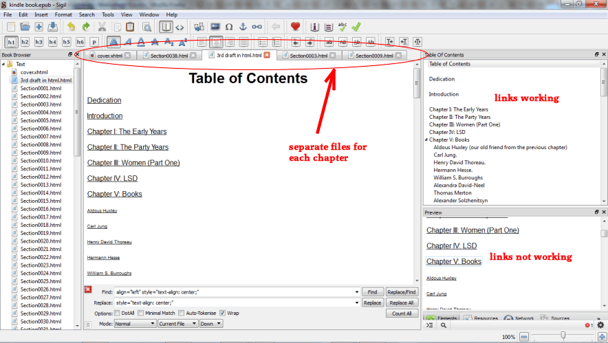

Yup, the preview function at amazon definitely shows that it's not working.
Ironically, this is the first time that I've used the sigil tutorials to assemble the toc. And the first time that I've had each chapter as a separate html file.
Are the separate html files (circled in red) the way to go?
Should I ensure that the links in the preview window work?
Thanks again in advance.

IMHO it is a clean way
It has nothing to do with TOC generation.
Sigil will use H# tags when you click the TOC button to generate the NCX
(there are tick boxes to hide items, and arrows to change levels BUT... care if you classes take the form h2.classname as the tag will no longer be a h2)
Caution: Save your work before clicking the 'Create HTML TOC' (only on the Tools Menu). This crashes frequently if the book has been modified during the session.
The Tools: TOC...: Create HTML converts the contents of existing NCX into a HTML page

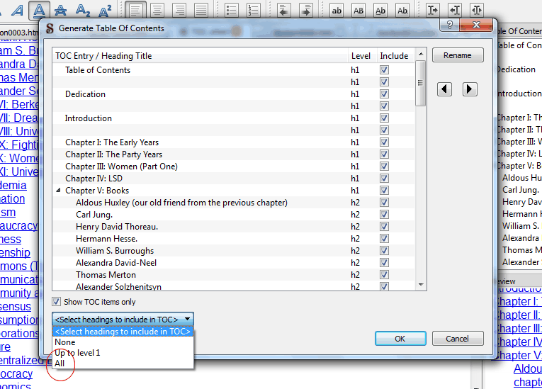

I don't know if this is relevant, but when I try to pull down the menu and select "all" (circled in red), sigil won't let me. It just reverts back to <select headings to include in toc>

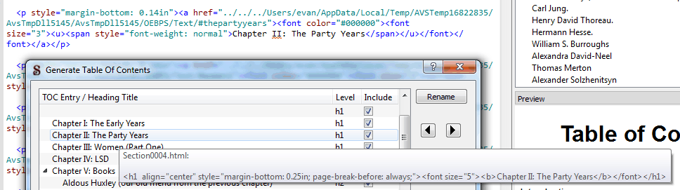

There's also this (attachment). A huge discrepancy between the html code and what the Generate TOC box says. Did I bring too much crap over from the odt file? Should I have used word2cleanhtml.com first?
That implies you only have Level (h)1
Select All, does not mean Tick All. It means Look for in the book.
saves time for example if you use H5 style for 'sign posts' in the story
The balloon help just shows the actual H tag contents that it is referring to.
Your TOC will include all the ticked item, indented as shown.
Note removing a tick also HIDES the item from the list. Remove the tick at the bottom to see a Candidates (and to re-enable those oopses

Looking at the HTML ToC which is partially visible in your screenshot gives it all away: with a link that goes to "../../../Users/Evan/AppData/Local/Temp/AVSTemp16822835/AVSTmpD115145/AVSTmpD115145/OEBPS/Text/#thepartyyears" it's no wonder the links go nowhere.
Use the Sigil feature to generate an HTML ToC; the links will work.
Looks like something went wrong with your links when you imported from LibreOffice. (?)

Links in Sigil's "Preview" pane will never "work." Do you have a special need to use the Preview widget (with the ability to examine all the various html resources) rather than simply using the Book View pane and the Table of Contents pane? In your case, I would suggest closing the "Preview" pane and not opening it again for any reason. It's confusing you unnecessarily.
