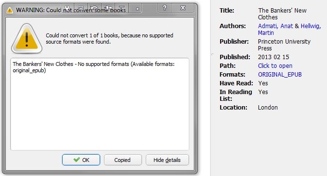

AFAIK - once created... by an EPUB to EPUB conversion or Polish Book... an ORIGINAL_EPUB will not be used in conversion
In any subsequent EPUB to EPUB conversion the existing EPUB is used as input and it will be overwritten by the output EPUB.
If there is only an ORIGINAL_EPUB then you can't even get a conversion - see attachment

I agree with your last point.

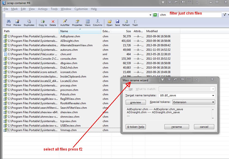

I hate trying to remember dos syntax for bulk file renaming
me too - at my time of life I can't be bothered trying to remember all that tedious dross.
Do yourself a favour get a copy of xplorer2 lite (it's free) it has a browse flat feature that's gives a flat view of files in folder hierarchy. Filter by 'original_epub', rename them to say original_save. Do your conversions then browse flat again and rename them back to original_epub.
In screen shot you see I am ready to rename all the chm files in my Program Files Portable folder (I forgot the . in front of the chm in the filter box, hence that stray xml)
