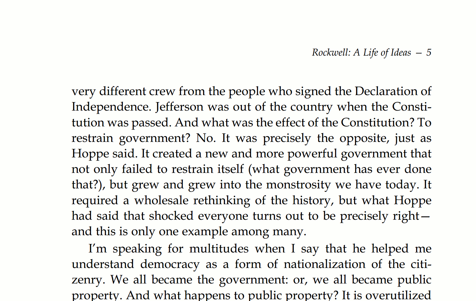

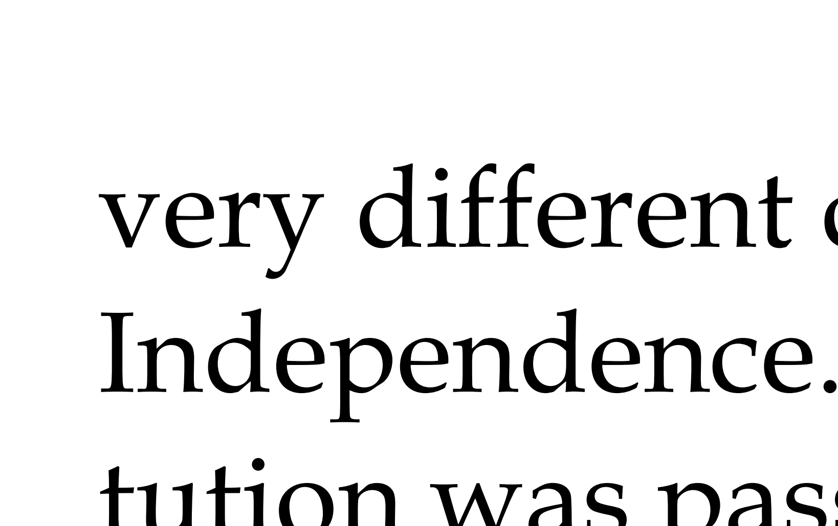

PDF is just about the worst format to convert FROM. PDF was built as a final output print format.
See this in Calibre's help files: http://manual.calibre-ebook.com/conv...#pdfconversion
In all cases, it is best to go back to the source document and work from there.
The best of the worst case scenario would be having a PDF created directly from the source (InDesign, Quark, etc.). You can tell when zooming in on the PDF, the text/graphs stay extremely crisp.
ID:	112573Click image for larger version
These might be able to have text extracted from them ok (although still a lot of errors can/will be introduced). I believe Calibre uses xpdf in the backend to handle pulling text out of PDFs:
http://www.foolabs.com/xpdf/download.html
Someone on the forums probably has a lot more experience with this type. I never work from this type (we usually have the source files for these).

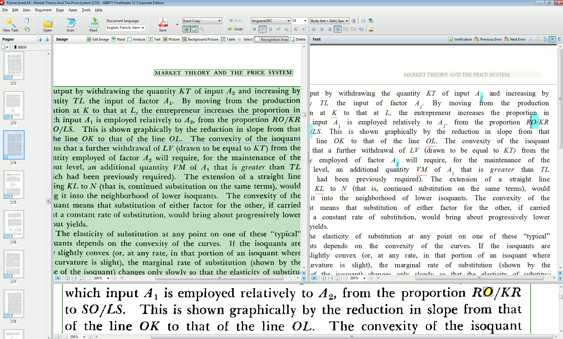

Here is a book in Finereader that I am currently working on converting:
Left = Original Document
Right = OCRed Text
Bottom = Magnified area in the original document
Even after export, you must still spend a lot of time fixing the output (combining paragraphs, removing accidental hyphens, adding formatting, splitting chapters, etc. etc.).

			= The images are unreadable on smaller devices
			- Does not scale with the text
			- Images take up a lot more space than HTML
			- A 100% HTML version of the table allows better for the long-term storage of the books.
				- In a future format, the HTML table can be converted easily.
				- Resolutions are only going to go up.
				- HTML tables are more accessible to those with disabilities
	- Keep an eye out for "m" -> "rn"
		- govemment -> government
		- bom -> born
		- tum -> turn
		- returm -> return
		- eam -> earn
		- modem -> modern
		- com -> corn
	- Keep an eye out for the capital letter "I" and the number "1"
		- I942 -> 1942
	- All errors in the actual text of the book should be marked in the format:
		- Page ###: paragraph #: Fixed Text
			This is the copied and pasted <b><i>sentance</i></b> out of the book as it appears in the text with the erro highlighted.
		- Paragraph 0 is used if the top paragraph has carried over from the previous page.
		- Make the actual text fix in the OCR
	- Try to pay attention to missing accents on characters
		- Bohm-Bawerk -> Böhm-Bawerk
	- Try to pay attention for missing quotation marks.  Depending on the book, sometimes ending punctuation + quotation marks are missing or become slashes.
		- . . / -> . . .” or . . .’
		- Sometimes entire ellipsis just are not OCRed
	- Pay attention for italicized variables
		- a, b, c, d  -> <i>a</i>, <i>b</i>, <i>c</i>, <i>d</i>
	- Quite often misspellings occur when a word carries over to the next page, or carries over to the next line (split by a hyphen).
	- Pay attention to two single left/right quotation marks ‘‘ ’’ instead of their proper left/right double quotes “ ”
		- Sometimes there are spaces between ‘ ‘ ’ ’
	- Do not try to "modernize" the words
		- If the book uses "co-ordination", "to-day", "per cent." or "coöperate", make sure you match the text exactly.
	- ellipsis, I personally avoid the unicode ellipsis character … and instead stick with the normal periods
		- Normal periods work better/look more consistent when there are more than three
		- Mixing ellipsis + normal periods looks very inconsistent.
After the OCR round:
	- Replace ONE BY ONE.
		- Search for ' and replace with a right single quote ’
			- Keep a left single quote ‘ in your copy/paste, so you can paste that instead if needed.
			- Quite often a prime is used.  Just keep that as a dumb apostrophe. (Many ereaders cannot handle the actual unicode prime character).
		- Search for " and replace with a right double quote ”
			- Keep a left double quote “ in your copy/paste, so you can paste that instead if needed.
			- Sometimes "two dumb apostrophes" '' are OCRed instead of the “smart quotes”
		- Search for /
			- These are not often used in a books, and usually these are typos from the OCR
EPUB Steps: Good to know basic XHTML/CSS.  Great to know Regular Expressions:
Regular Expressions
	http://www.regular-expressions.info/
	https://www.mobileread.com/forums/sho...d.php?t=167971
	- Versioning system
		- Use the date and/or version number
			- Last,First.-.Title.of.Book[MM.DD.YYYY].epub
			- Last,First.-.Title.of.Book[MM.DD.YYYY][v.1].epub
			- Save OFTEN, and save a different version BEFORE you try to do any large search/replaces, and up the version number after doing a major "pass" on the EPUB
				- For example, you just finish a spellcheck pass, bump the version from v.2 -> v.3.
Step 1: Split chapters
Step 2: Set up headers
Step 3: Set up blockquotes
	- I try to combine the paragraphs here, match the formatting
		- For example, if the author of the quote is right justified
	- Combine paragraphs if needed
Step 4: Find/Order footnotes
	- Doublecheck that all footnotes are there.
	- Place them at the end of the chapter in the order they were found in the book.
Step 5: Combine paragraphs:
	- Search: -</p>\s+<p>
	- Replace: (BLANK)
		- This will combine paragraphs that end with a hyphen (usually a word carried over from one page to the next)
		- If it is an actual hyphen, then manually combine the paragraphs
	- Search: ([^>”\?\!\.])</p>\s+<p>
	- Replace: \1
		- This will catch any paragraph that does not end in a punctuation mark
		- Note: There is a space after the \1
		- Note: This WILL catch paragraphs that end with a right parenthesis ) and colon :.
			- These are sometimes valid, sometimes not.
Step ?: Pay attention to upper left corner of page, if you see no indentation, and a capital letter (this most likely means it is a continuation of the paragraph from the page before).  Search for that phrase in the EPUB, and make sure it is combined with the above paragraph.
Index
	- Search: ([0-9]) ([A-Z])
	- Replace: \1</p> <p class="index">\2
		- This will look for any number followed by a space, and a capital letter
		- Make sure you have selected "Current File" in Sigil, to make sure this only effects the Index.
Final Passes:
	en dash
	- Search: ([0-9])-([0-9])
	- Replace: \1–\2
