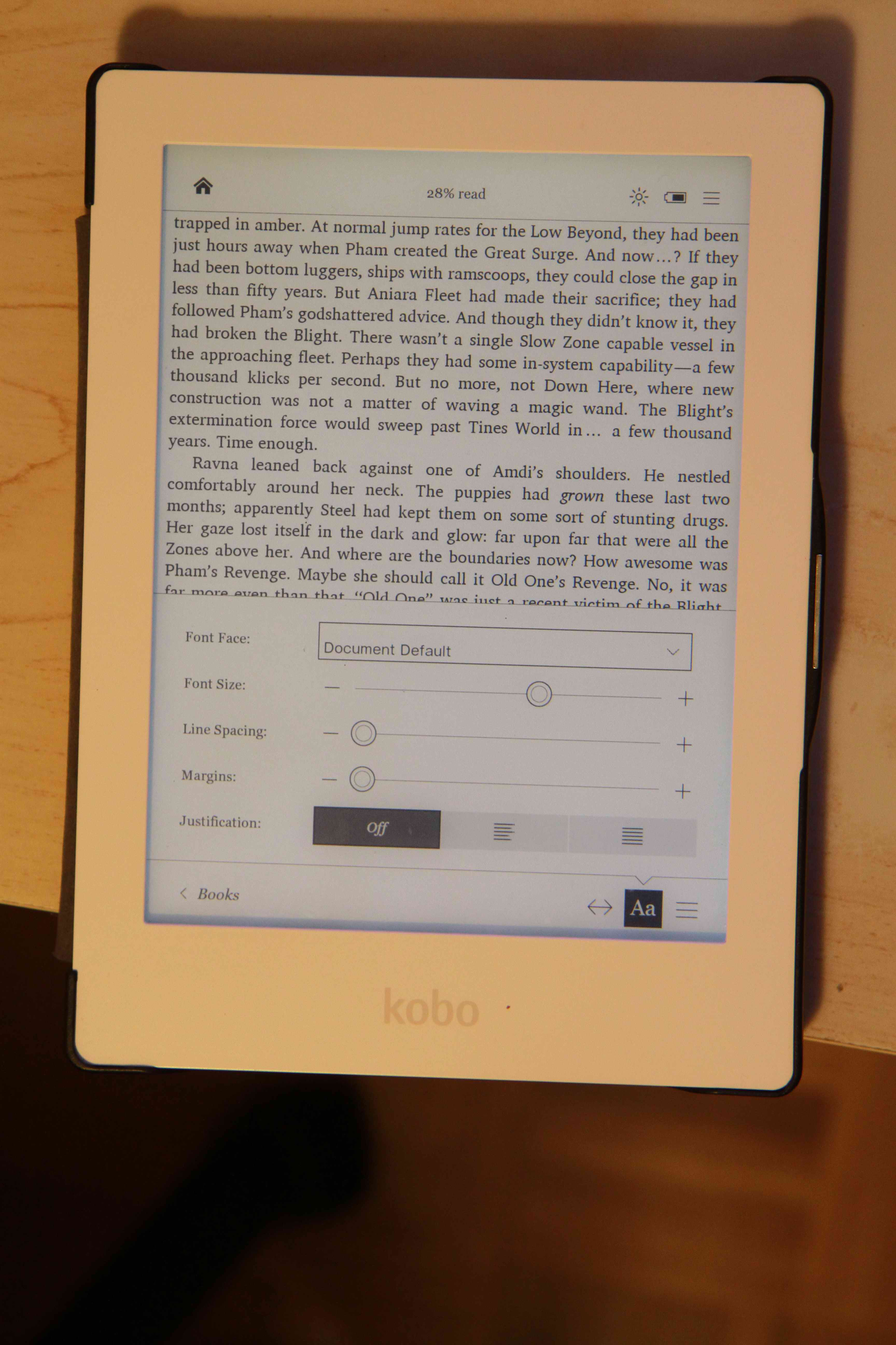

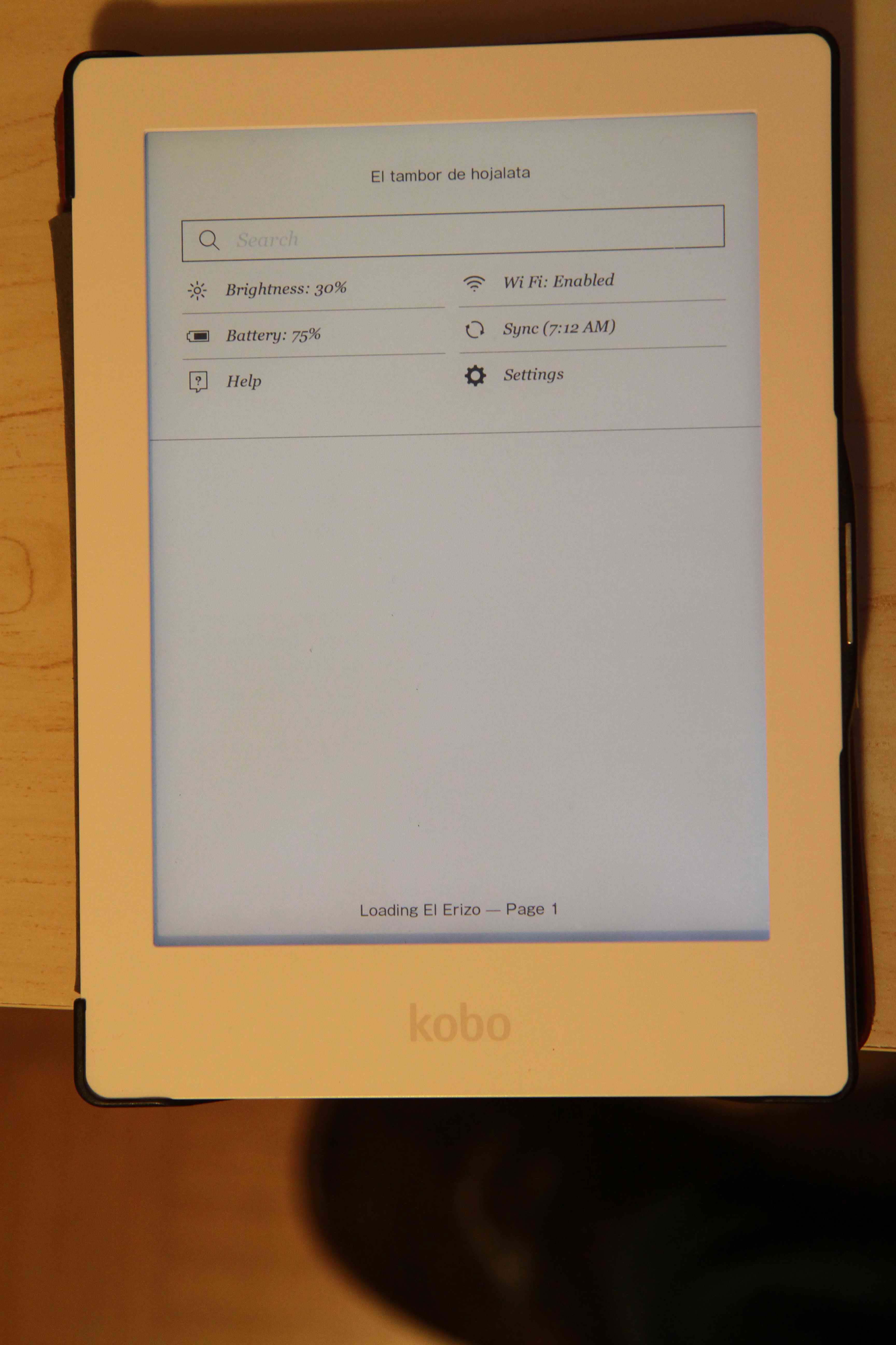

Hi, I'm going to post an issue that it randomly appears in my Aura HD.
I'm currently on 3.1.1 but this issue has been also present in older FWs.
Look at the attached screenshot ("Fake Loading crash.jpg"). That screen usually appears briefly when you open a book from home screen/library or when you perform chapter jumps from ToC viewer (or even when you finish one and open the next). But as I said it briefly appears while the chapter is being loaded and then it disappears and your new book page is rendered...
Well, as you can imagine, the issue is that it RANDOMLY stays forever. And my AuraHD seems completely frozen. I can touch whatever I want, the screen is always there. The only possible solution (which I always took till I discovered it was a FAKE crash) is holding power button for a long time till the device powers off, (still with the same screen), and then powering it on again. But then if I reopen the book, (it will appear as the last opened one in home screen), it is VEEEERY likely that I'll get the same fake crash.
And now the solution. The Aura HD is not crashed/frozen at all. The real issue is that this screen is kept on top of the normal rendering of the book. The real issue is that this screen is not removed. But I can remove it with the next procedure:
  • Tap in the middle of the screen. Menu is actually called although I don't see it.
  • Tap in the upper right corner (where the three bars are actually located). Menu is actually expanded and RENDERED. (Screenshot attached: "Loading crash being solved.jpg").
  • Tap outside the menu. It is contracted AND the "Loading page" is removed.

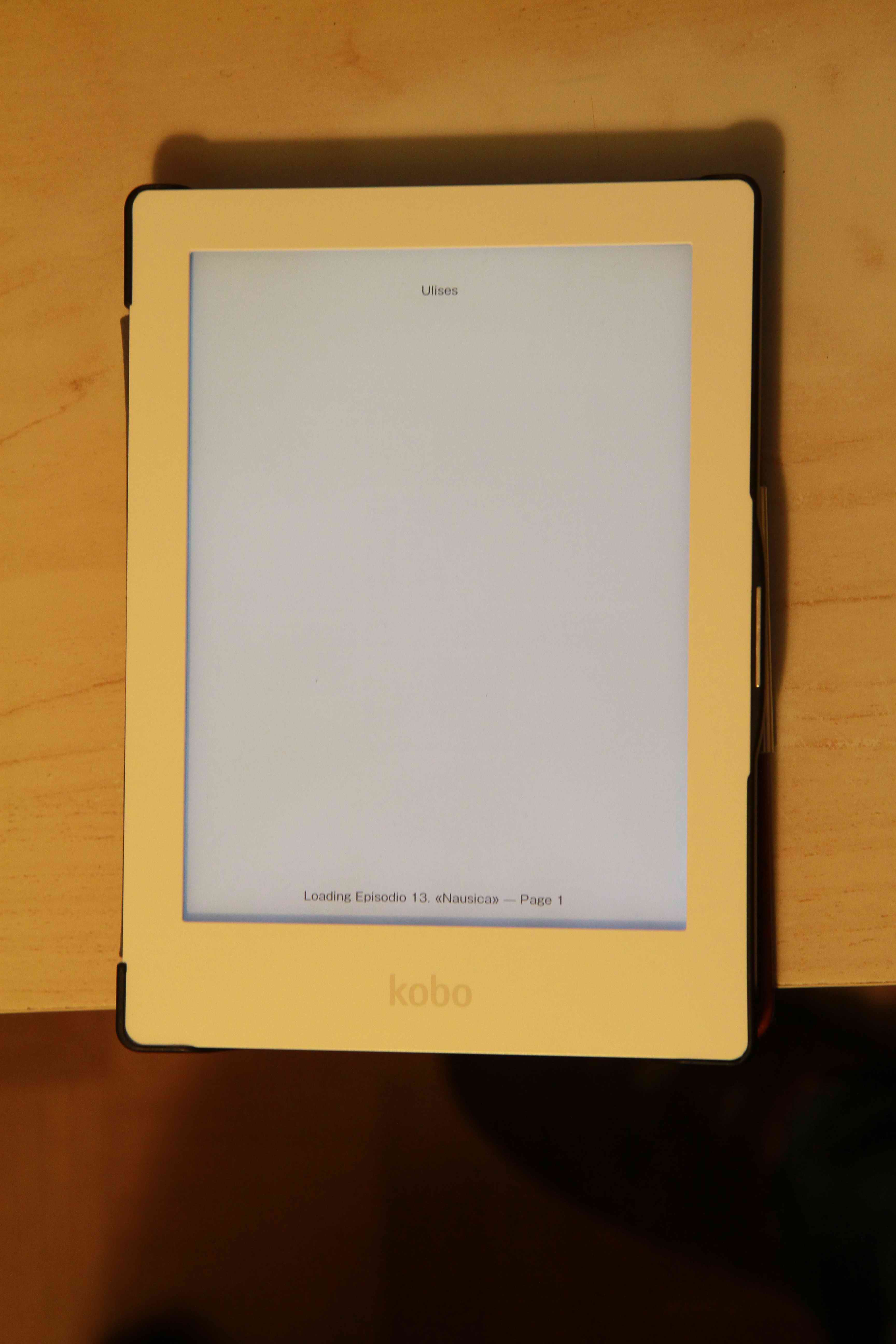

The problem about providing an example is it randomly appears on every book I've read (IIRC). But I haven't found an exact trigger so far, other than happening usually on book opening (normally coming from another book) or happening after a ToC jump to other chapter. It haven't happened a single time (IIRC) while normally reading and going from one chapter to the next/previous.
I'm completely sure it happened with "Zones of Thought Trilogy" (which has embedded fonts in it), and with "The Carpet People" and "El tambor de hojalata" which haven't got.
Nevertheless, now that you mention it I remember the slow first loading time in "Zones of Thought" (with embedded fonts) which doesn't happen in my current "El tambor de hojalata" (without them).
EDITED ---------

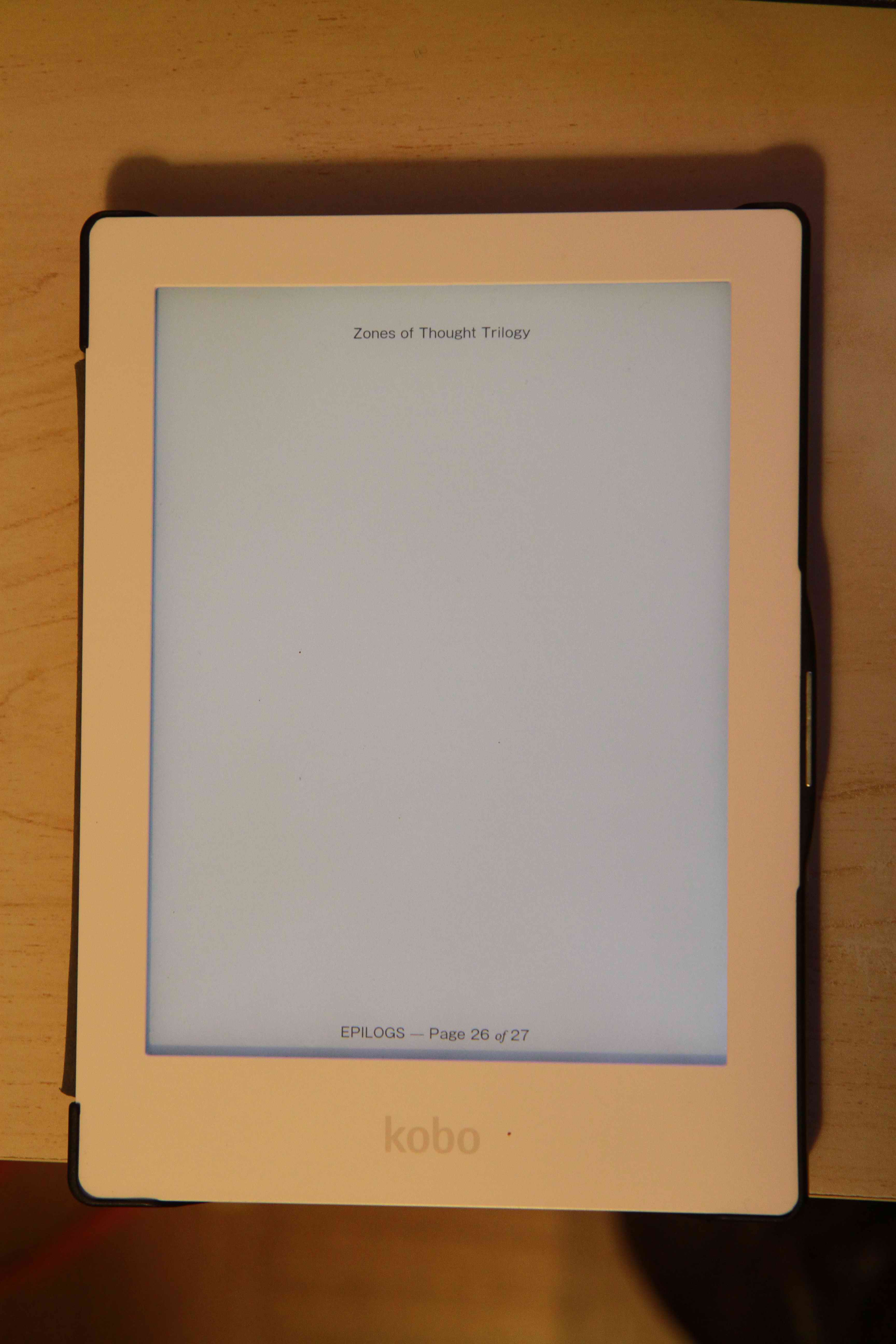

HEY!!!, testing with "Zones of Thought" I've got ANOTHER similar issue which it isn't the same. (One issue that now I'm seeming to remember happening in the past, and not having posted... )
Look at the "This seems a different issue.jpg" picture.
It really seems like my first "Fake loading crash.jpg" but it isn't. Look at the footer. There's no "Loading" text and there's "Page xx of xx" instead of just "Page xx".
More over, the device doesn't even seem frozen at all. If I touch the screen, menu is called and rendered. (Look at "Being solved step 1.jpg"). And you can believe me that you can turn pages, (so Page 27 of 27, I've been fully silly: I haven't tested advancing another one to the next chapter; although this is a book where chapters are in the same HTML file, so probably there won't be a new file loading...).
So it would just seem that something has gone wrong with the book/font/text rendering but not with the device itself running (contrary to my original post)!!!

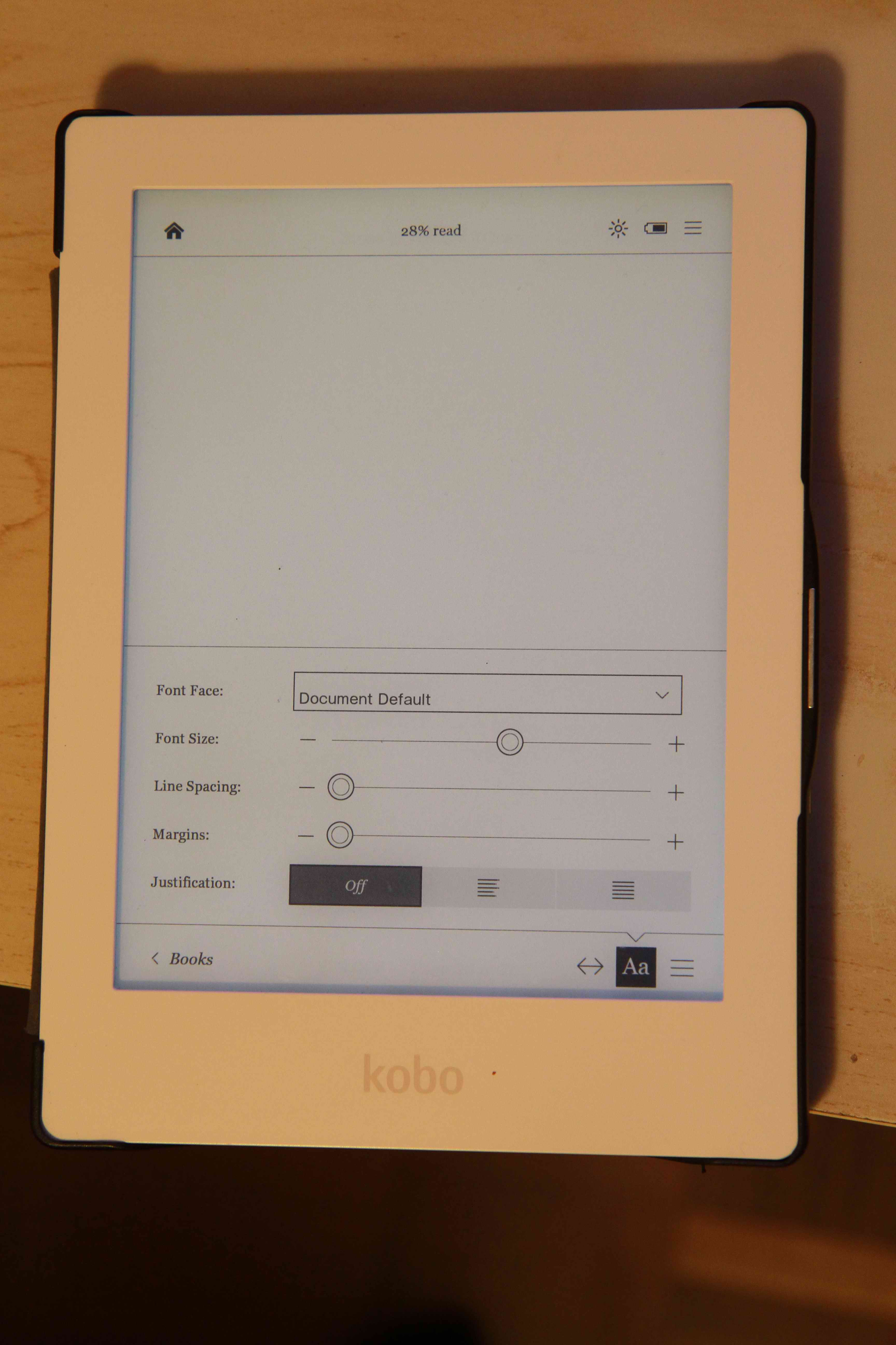

Workaround/fix: if I just change font size, the text reappears. (Look at "Being solved step 2.jpg" where the font size is just one step bigger).
Could you check if this is the trouble you refer about "embedded fonts"?

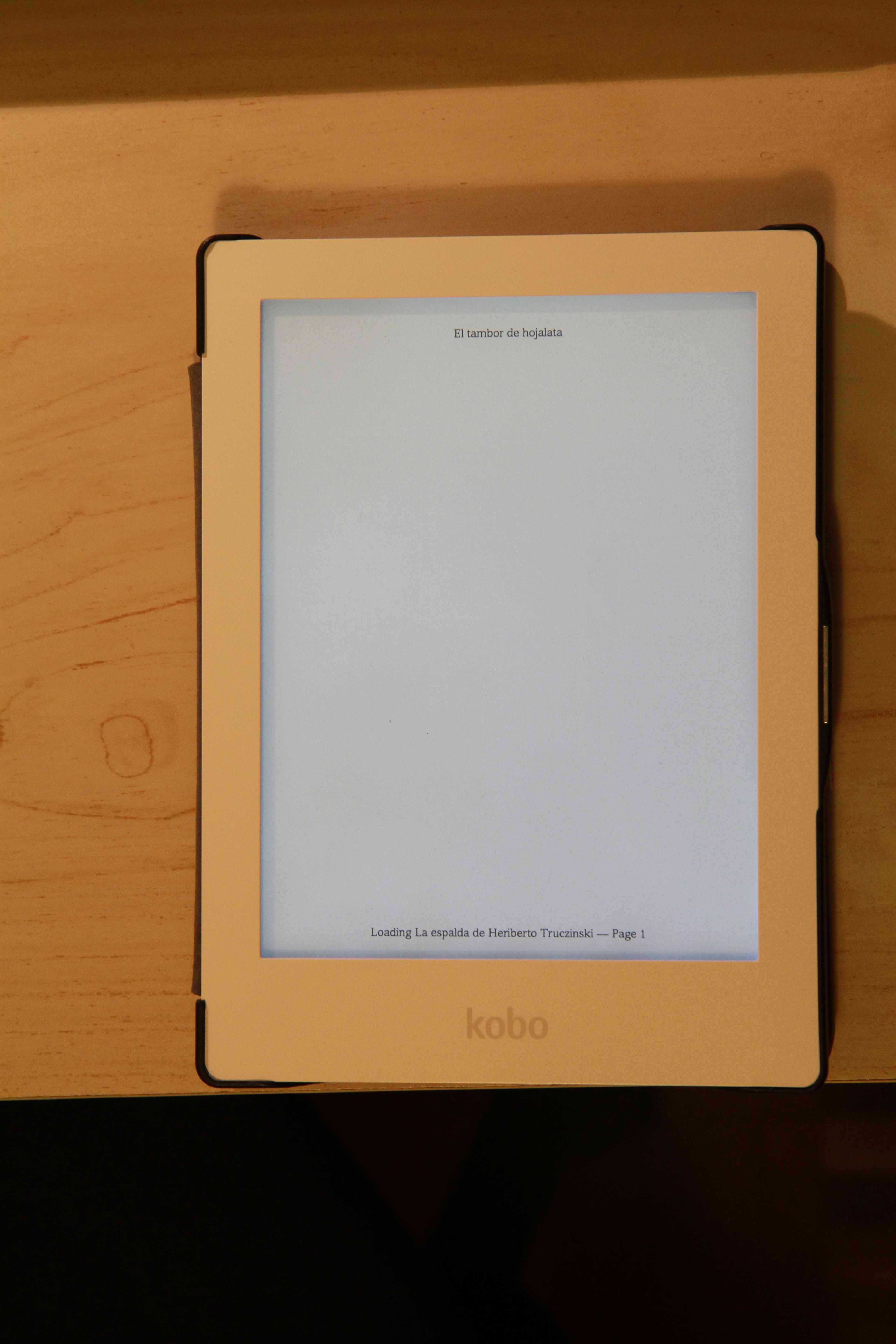

@davidfor: I really think that both issues (blank pages but responsiveness with embedded fonts vs this pseudo-freezing) are different issues even if related somehow.
I've followed your hints and after some tests I've got the false freezing one with "Amasis". Look at the attached picture. It's from my current reading "El tambor de hojalata" which also appears in the first post, in that case with "Default Document".
