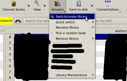

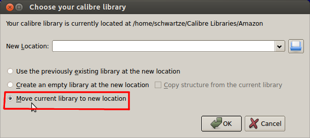

Old 12-20-2013, 05:26 PM   #10
eschwartz
Ex-Helpdesk Junkie
eschwartz's Avatar
Posts: 19,421
Karma: 85400180
Join Date: Nov 2012
In screenshot one you see how to manage libraries. First option, highlighted, will open up the popup in the second screenshot. Highlighted option will move the Calibre Library folder and record the change in calibre's settings.
ID:	116958   Click image for larger version
