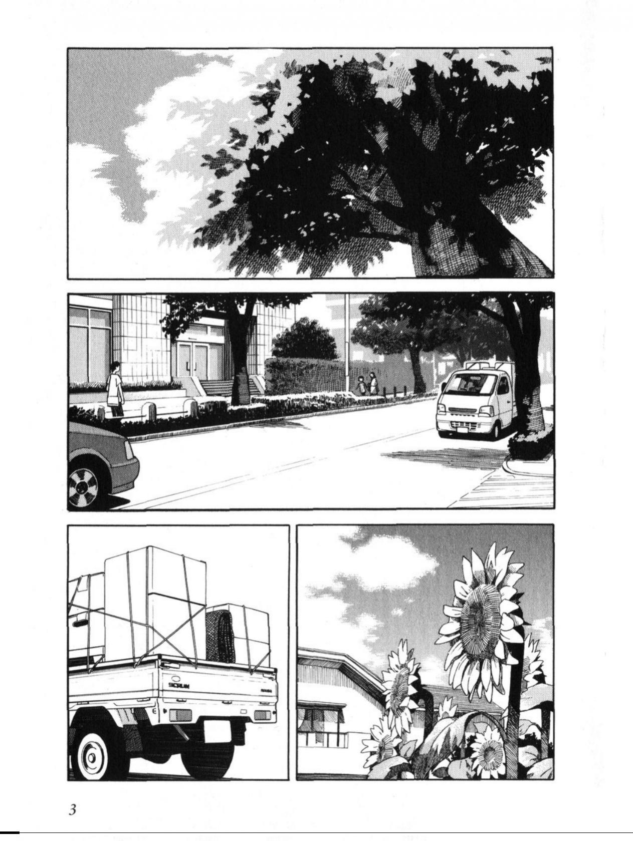

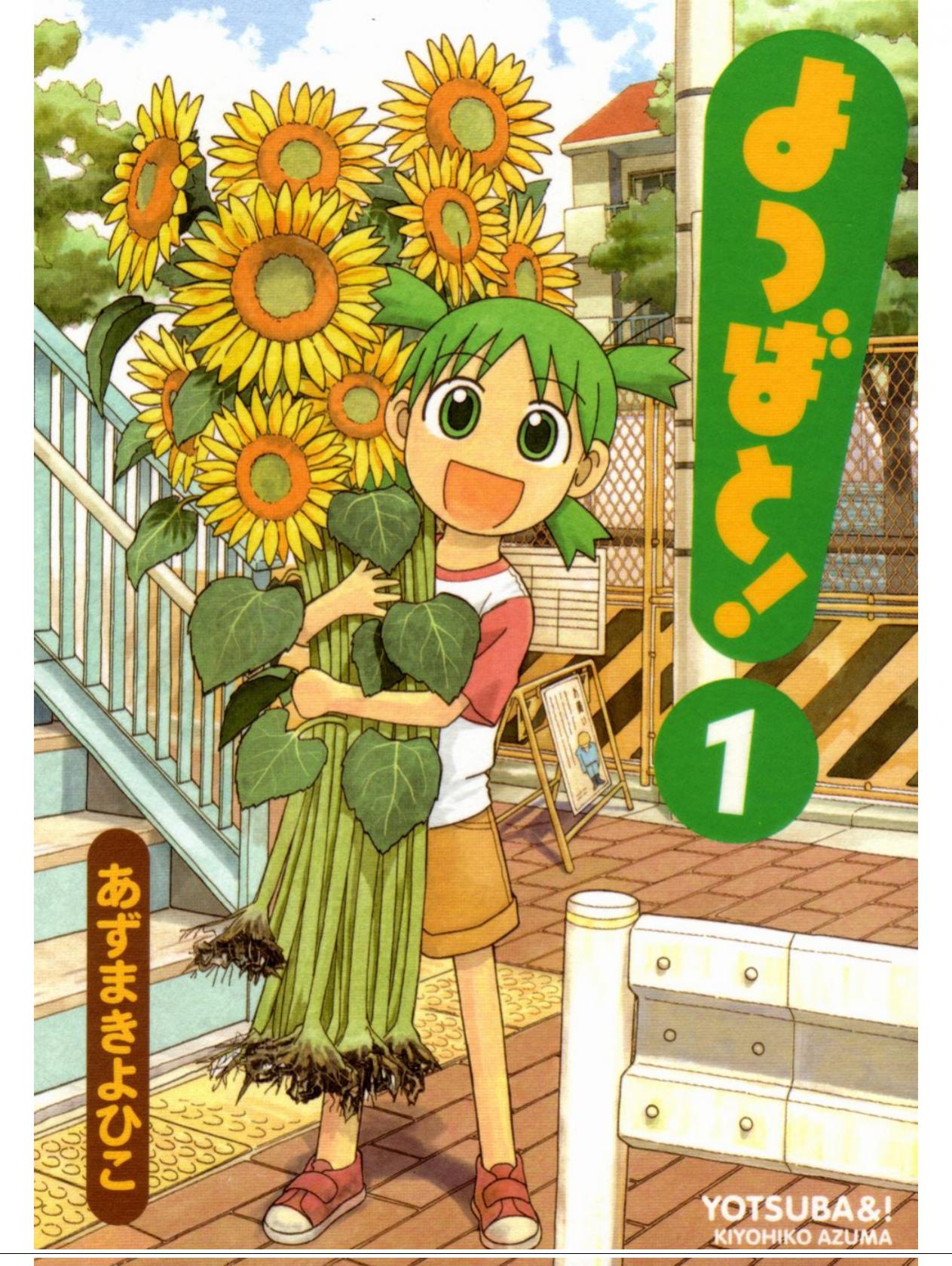

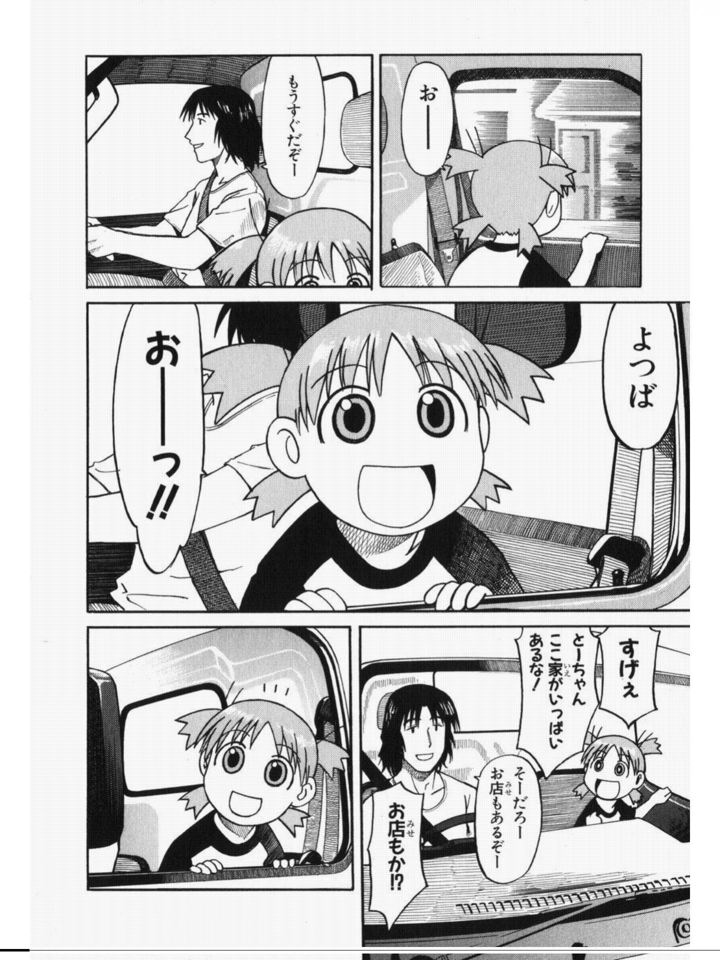

ID:	212094   Click image for larger version
ID:	212095   Click image for larger version
