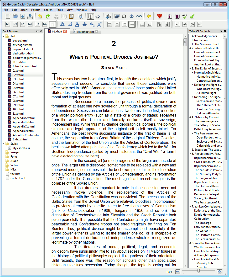

Here is the way the book looks in Book View. As you can see, I have a slight indentation (1.2 em) at each paragraph:

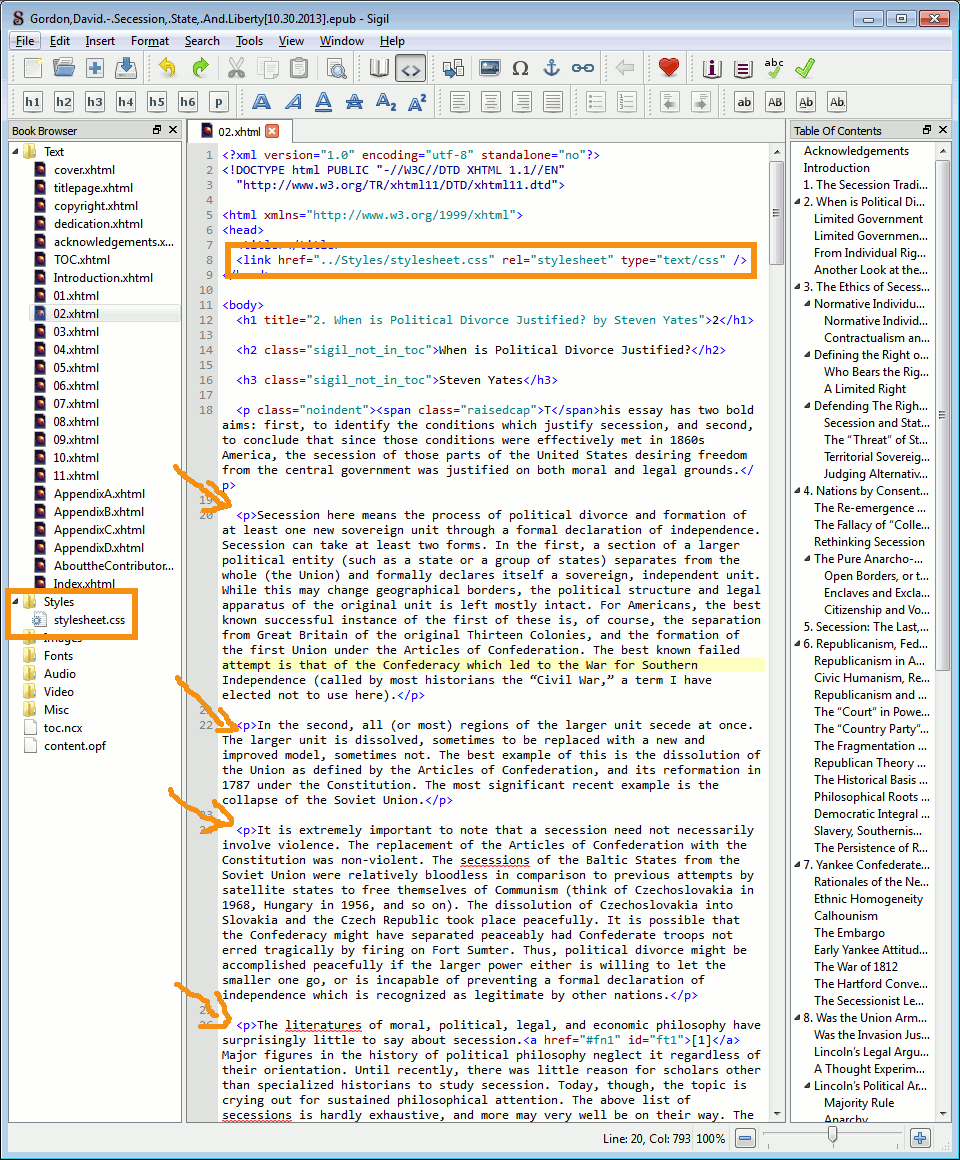

If you get to the Code View (View - Code View) (or the button on the top menu, it looks like a "<>"). You will see all of your code:
At the top, you hopefully see something like:
  <link href="../Styles/stylesheet.css" rel="stylesheet" type="text/css" />
This means that CSS is being applied to your document. On the left side of Sigil, you should see a folder named "Styles", with that CSS file inside (in my case, the stylesheet is called "stylesheet.css").
Side Note: If you DO NOT see a CSS file in your Styles folder. That means you will have to create one.
Side Note #2: If you see a CSS file in your "Styles" folder, but DO NOT see the <link href [...]> at the top of your code, you can easily do this by following the instructions here for "Link Stylesheet": http://web.sigil.googlecode.com/git/...xt/styles.html

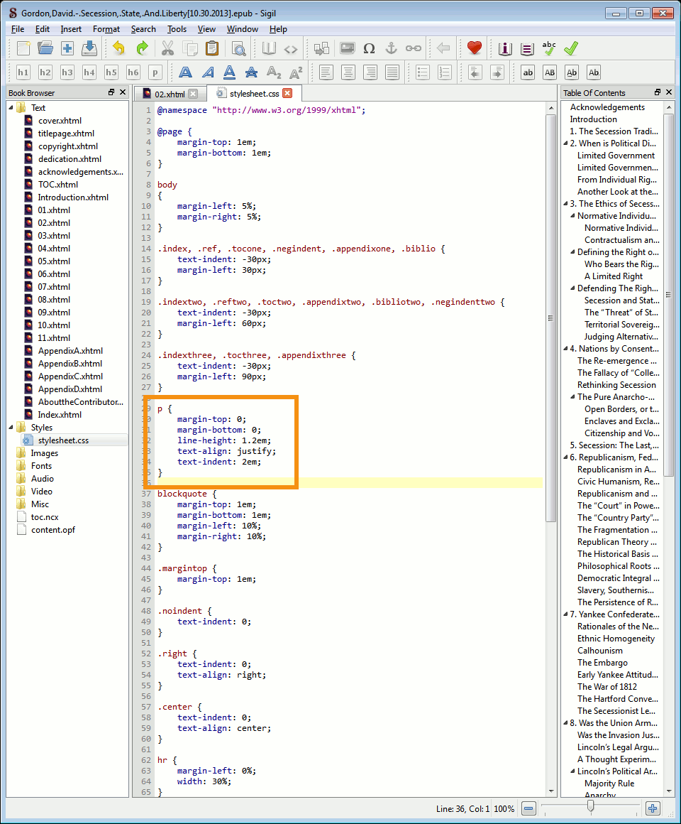

If you open that the CSS stylesheet, you should hopefully see some generic code. What you are looking for is the section which assigns styles to "p" tags:
It is this area where you want to add "text-indent: #.#em;", where "#.#" is the amount of spacing you want, and "em" is the unit of spacing ("1em" is approximately the width of one 'M' character).
Usually, it is recommended to use anywhere between 1 to 2 em (I prefer 2em, JSWolf prefers 1.2em, others prefer smaller/larger).
