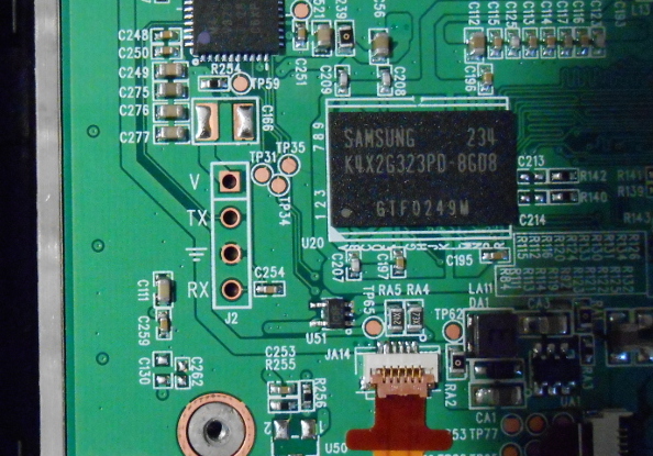

Hello everyone, I got a kobo mini a couple of weeks ago with the intention of using it as the display for an alarm clock. It'll be connected to other stuff eventually, and run a small program that does display, handles input and triggers other bits of kit (lamp, buzzer, radio etc).
I've used the great hacking guides here on the forum to telnet in - thank you all very much for posting those. I've also opened it up to solder in a header to the serial pins. Does anybody have any experience of reading / writing info from those pins? Does the serial port show up by default in the OS, or will I have to do some tinkering to get it visible?
The other this was that looking at the PCB, the outside edge is lined with what appear to be LEDs. The top and right edge have clear packages and are labelled D<number>, and the bottom and left edge are dark, like IR receivers of some sort, and labelled Q<number>.
They are definitely optical components but I can't see what they do. The case has a series of scalloped lenses inside it, that match up to the components. I can't see anything similar in any teardown pics of other e-ink devices, so I'm guessing it's something to do with the touch sensors? Puzzled. Any ideas? I'm just curious really.

Hi Kevin, first of all I want to say thanks for the work you've done, and written up about getting pygame etc running on the Kobo - dead useful and very encouraging.
The kobo mini is the only one I've used, and that has a hardware serial port present on the PCB itself (bottom right corner of the PCB in the middle pic in my original post). The kobo touch has the same port, so I assume the glo does too, but I can't find a teardown of it to look at.
All I did was solder some sockets into those holes. The pins exposed are GND, RX, TX and +3.3V, of which you need to connect up only GND, RX, TX. So that gets you a TTL serial port which might be useful if you're interfacing with another TTL thing, like an arduino or something. But for connecting to a computer I needed a TTL-to-USB converter.
I used one of these
http://www.elecfreaks.com/store/ardu...pter-p-16.html because I wanted the other features on it,
but there's lots of different kinds (http://shop.moderndevice.com/products/usb-bub), including ones that are built into the cable (http://www.tronisoft.com/prod.php?id=2472). Just as long as it's a 3.3v version rather than a 5v version. Most of the PCB-ish ones can be switched to 3.3 or 5v with a switch or jumper.
So use jumper wires (http://www.elecfreaks.com/store/1-pi...pcs-p-165.html) to connect the transmit (TX) of the kobo to the receive (RX) of the usb adapter, the kobo RX to the adapter TX, and the kobo GND to the adapter GND. Don't need to worry about the kobo supply (3.3v) since the usb adapter is already powered over the usb bus.
The usb device (cable, bub, adapter whatever it is) shows up as a virtual com port on the PC, and I used PuTTY to connect to it. PuTTY has a "serial" method of connection, and I just used the default settings I think, but I can check that later if you like.
My problem is that the root terminal that is exposed this way (which is the same as the one that is exposed over the wifi telnet thing) is exactly that - the root terminal. So all the activity on the kobo is being reported over it, so there's a lot of noise. For my purpose, I want a fairly clean channel that I can pipe commands over, that isn't going to be interrupted by the kobo system's messages every now and then. So I think what I might try to do is get the usb-ethernet set up instead, and ssh between the kobo and the pi. I couldn't get the usb-ethernet working last time I tried, so it's time to try again.
Maybe that's helpful! Anything you want me to test, just ask.

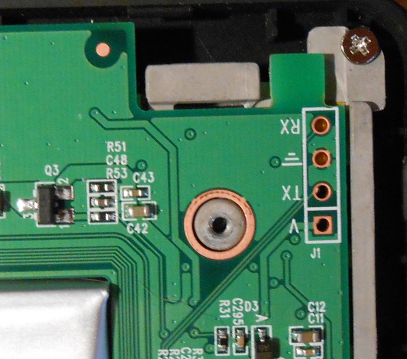

Thanks for the great writeup, euphy. Getting all the Kobo's activity is exactly why I want to setup a serial connection. Someday I'm planning on trying to port Android to the Kobo.
There seems to be two serial ports on my Glo. One is at the upper-right corner of the board and labeled "J1", and the other is near the bottom-left and marked "J2".

I decided to order this TTL to USB adapter, and it just arrived today. I followed euphy's directions on connecting the adapter to the Kobo, and it's working perfectly so far. Thanks, euphy!
I didn't notice it before, but the Glo actually has three serial ports. The only one I've been able to get anything out of is J3, however.
