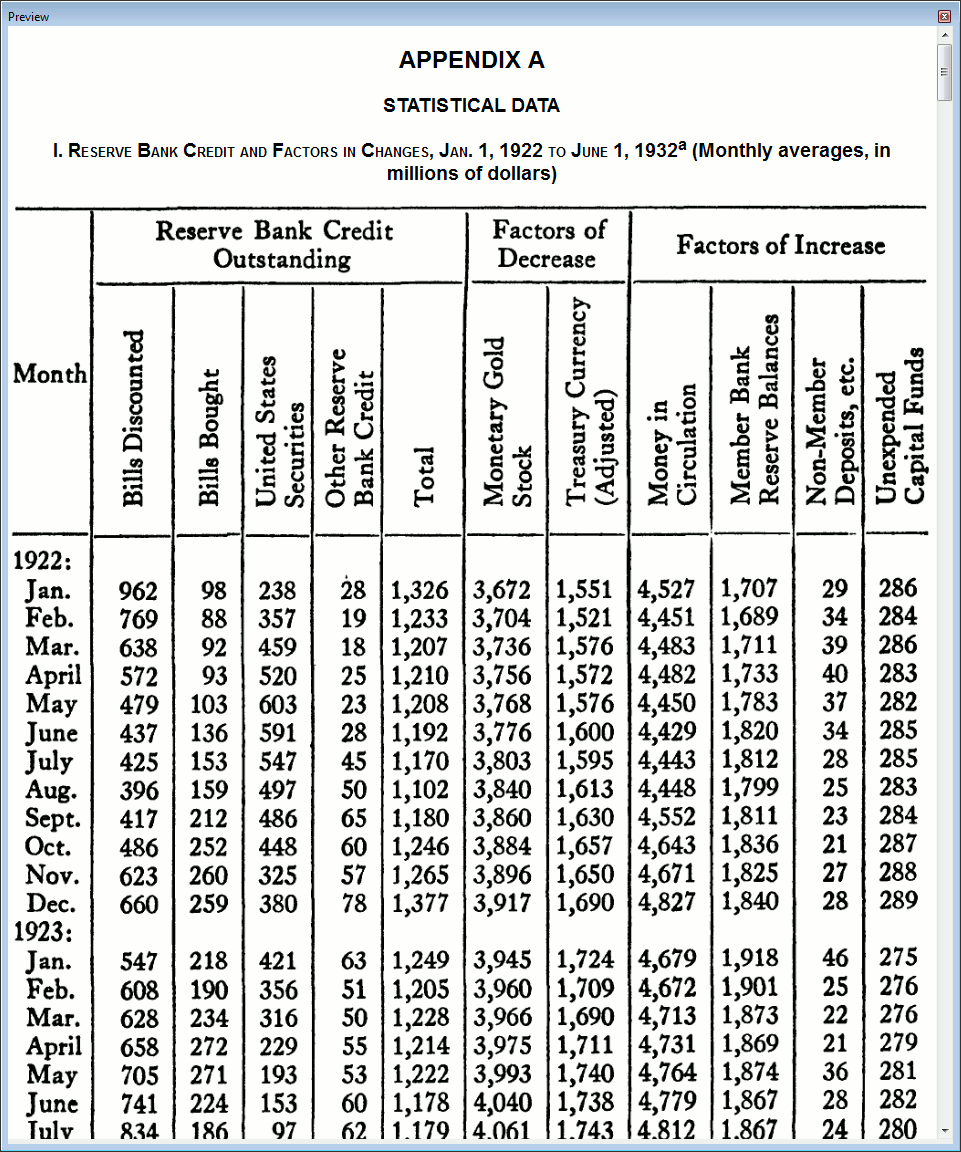

Folks,
I am in the middle of converting a pdf to an epub. The source includes several large tables (example .jpeg attached).
Currently, I'm just generating them as jpegs, but have been considering converting them to <table>s in the html. My strong intuition is that a table this wide in html isn't going to render in a sane way on any current ereader, and this isn't worth pursuing.
Are jpegs the best way to go with tables like this?

Almost always unless you can be sure they will be displayed on a large tablet. Even then somebody can increase the font size and blow up the table.
You might want to experiment with different types of images, gif, png, etc to see what gives you the best image for the least memory consumption. Probably not too big a deal if there are only a few of them.
HTML tables can be hard to center as well, without messing up the formatting inside the table.
Images are pretty easy to snapshot out of the pdf. Just make sure your viewer program snapshot is set to as good a resolution as you need.

Thanks. There are 4 of them. I'm probably going to just stick with jpegs.

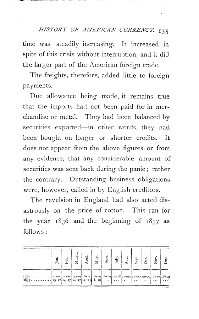

Here is an example of a table I "verticalized" + some more JPG-PNG examples.
Original Page from the PDF:

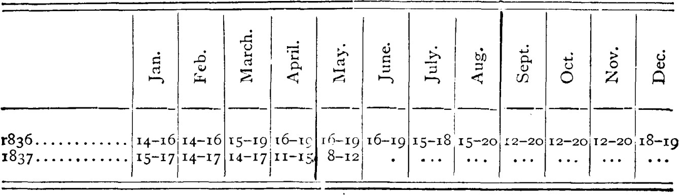

Here is an image of my "verticalized" HTML table in Sigil:

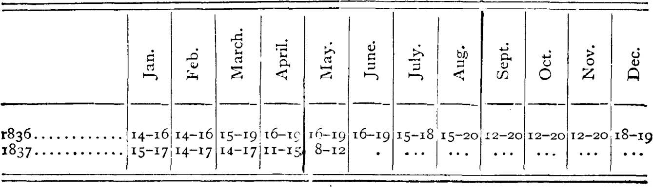

PNG (Grayscale PNG saved right from GIMP + Compressed with ScriptPNG):
ID:	111746Click image for larger version
The filesize is 37.8 KB and 31.3 KB. These images have ZERO artifacting, and are less than half the size of those JPGs.

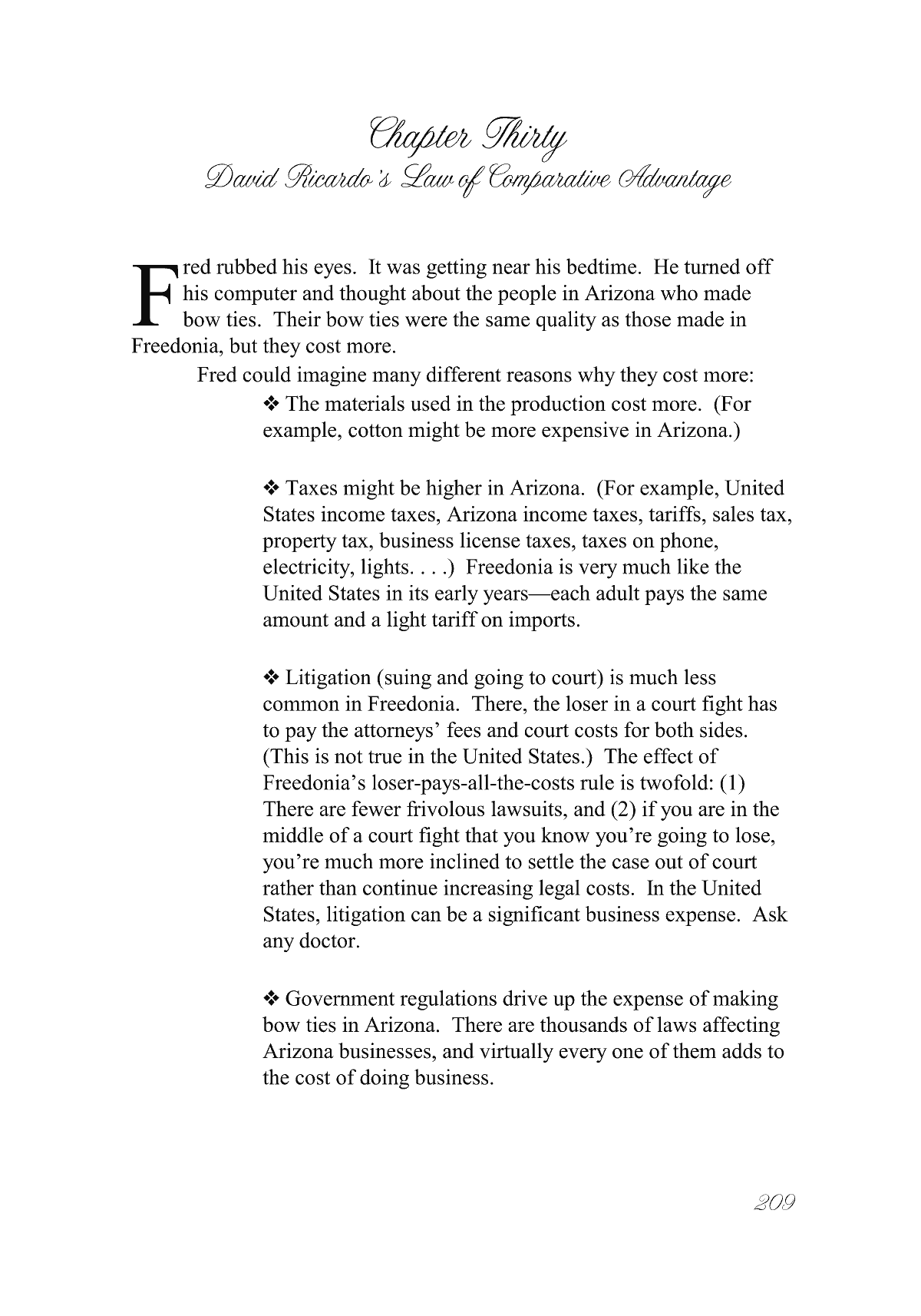

Here is a real life example of the horrible conversion/JPG artifacting you might run into (and the HUGE filesize of JPG compared to PNG):
Original image was done by the author, and was probably generated by some sort of crappy PDF -> image conversion (800+ KB JPG). Artifacting left and right, and that filesize should make you gasp!!

I got the source document from the author, and was able to generate a PNG (42.9 KB)):
I must admit, it was a "lossy" PNG conversion since I Indexed it to 4 gray colors.

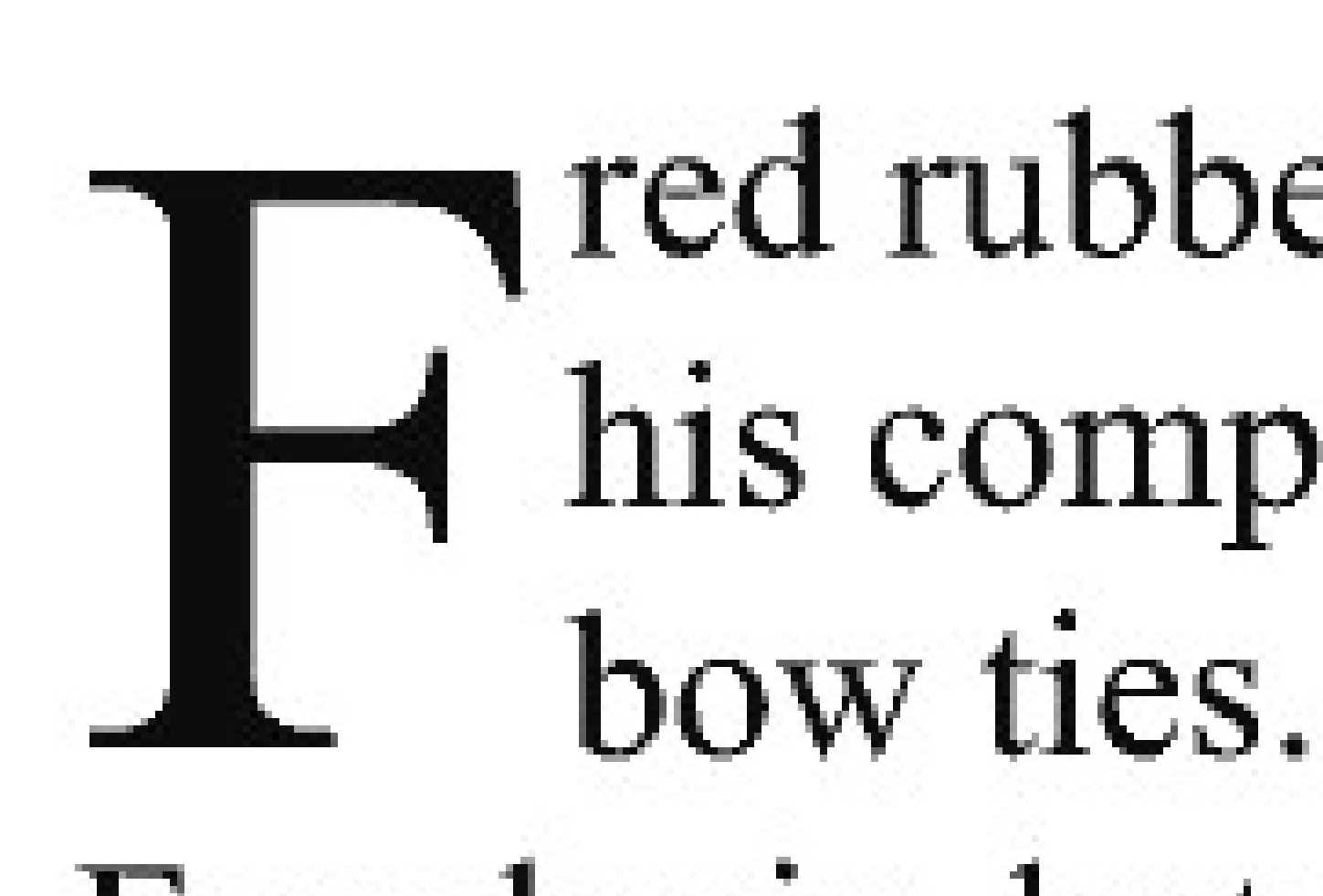

Grayscale JPG (90 quality) (257 KB):
Grayscale JPG (80 quality) (203 KB):
Artifacts between PNG + 90 JPG + 80 JPG:

As you can see, the "halo"ing gets worse and worse the lower quality you go with JPG.
A GIF would look exactly like the PNG version (no haloing artifacts), BUT the GIF will have a larger filesize.
