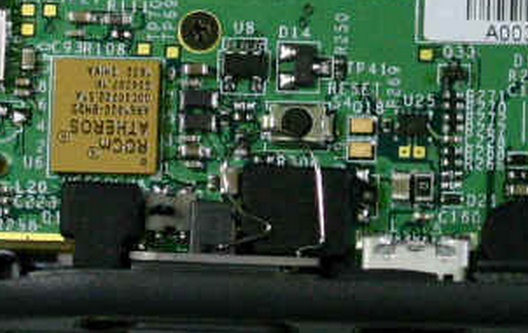

The "power switch" is one tiny grasshopper leg spring attached to a bit of plastic.
You been inside to see if it just "popped of" its moorings?
I would just rip it out and "poke" the button some other way, over not using it.

right. but the 3's just clip apart unless you have an ex-demo one.
worth a look
EDIT: Not the best picture ever but yeah... you can see the leg spring and how the plastic bit just trips a momentary switch.
Tiny switch on left is grey with black button... plastic bit merely collides with it to trigger.
Caveman style
