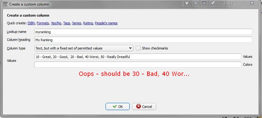

Prefix with '10', '20'... then you'll have gaps for inserting intermediate values

@Riva3000 - see attachment, I find I don't even see the digits after a while.
And you can add '15 Very Good

Ah sure. Thanks for a tip !
Im affraid thats not very elegant solution tough. The numbers will show in the column and everywhere else as well (right ?)
Is there any better way to do it ? A 'proper' way to do it ?
