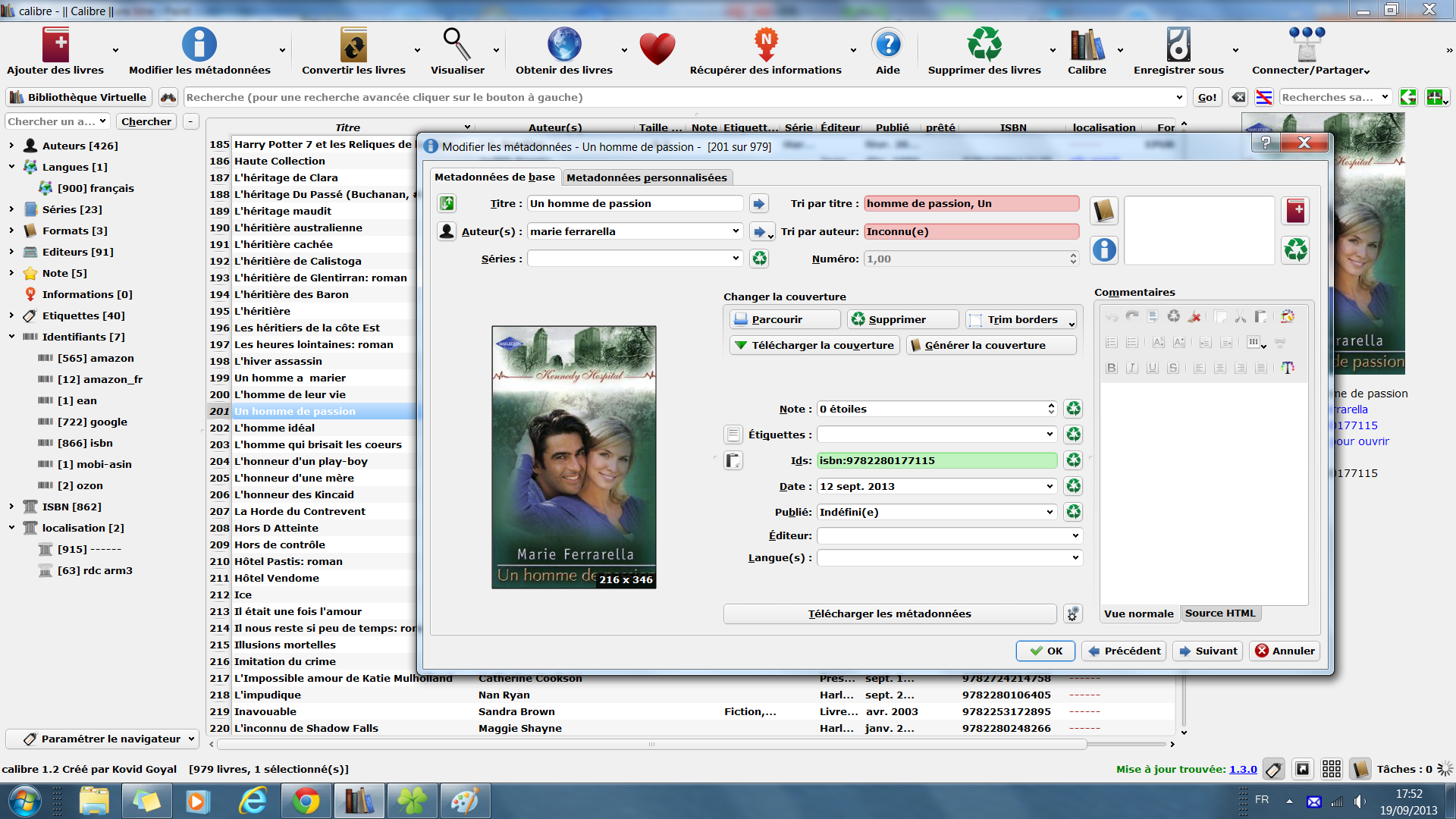

hi
i have another problem..
i have many books with invalid 'sort by title'
ex:
title :'Un homme a marier'
sort by title :'homme a marier, Un'
see hardcopy attached
i woulld like to have ALL field 'sort by title' same as field 'title'
it enables me to sort TITLE strictly_alphabetic
many thanks for your support ...

I found a solution :
use 'Sqlite database browser ' for browsing metadata.db and make a sql command for replacing ...
but if you have another solution ...

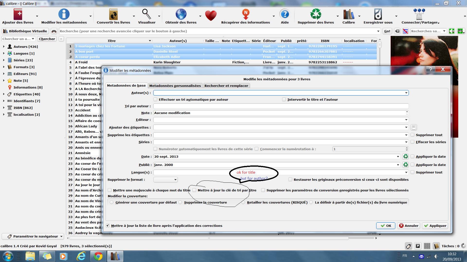

So use the Update title sort option in the bulk metadata edit dialog.
have you the same solution for Author ???
jcarlier is offline   Reply With Quote

Select a couple of books and actually look at the Bulk metadata edit window.

i don't see where you can replace 'sort on author' by 'author' on Bulk metadata edit window
see hard copy

It is a combination of first applying the tweak and then updating the titles using the bulk edit metadata dialog. Otherwise only new or manually edited titles use the tweak.

The one right under the Authors box (I won't try the French ).
That works even if you enter nothing else on the form because it reads Authors and calculate the sort based upon the current (Tweaks) Rule

The Search and Replace tab (bulk metadata edit window) should work for this, but you'll need someone else to guide you if you need help.
You can go the other way (from Author_sort to Author) by going to the tag browser, right clicking on Author and selecting Manage Authors.
He doesn't want to set Author_sort he wants to mass copy Author to Author_sort.

If the author_sort_copy_method tweak is 'Copy', that will be the result of Automatically setting (from Authors)
I use this all the time to get rid of the Red's detected by the QC PI
Excellent, so walk him through the tweak and he should be all set.
ok for the new entries but quid for the old ones ??
