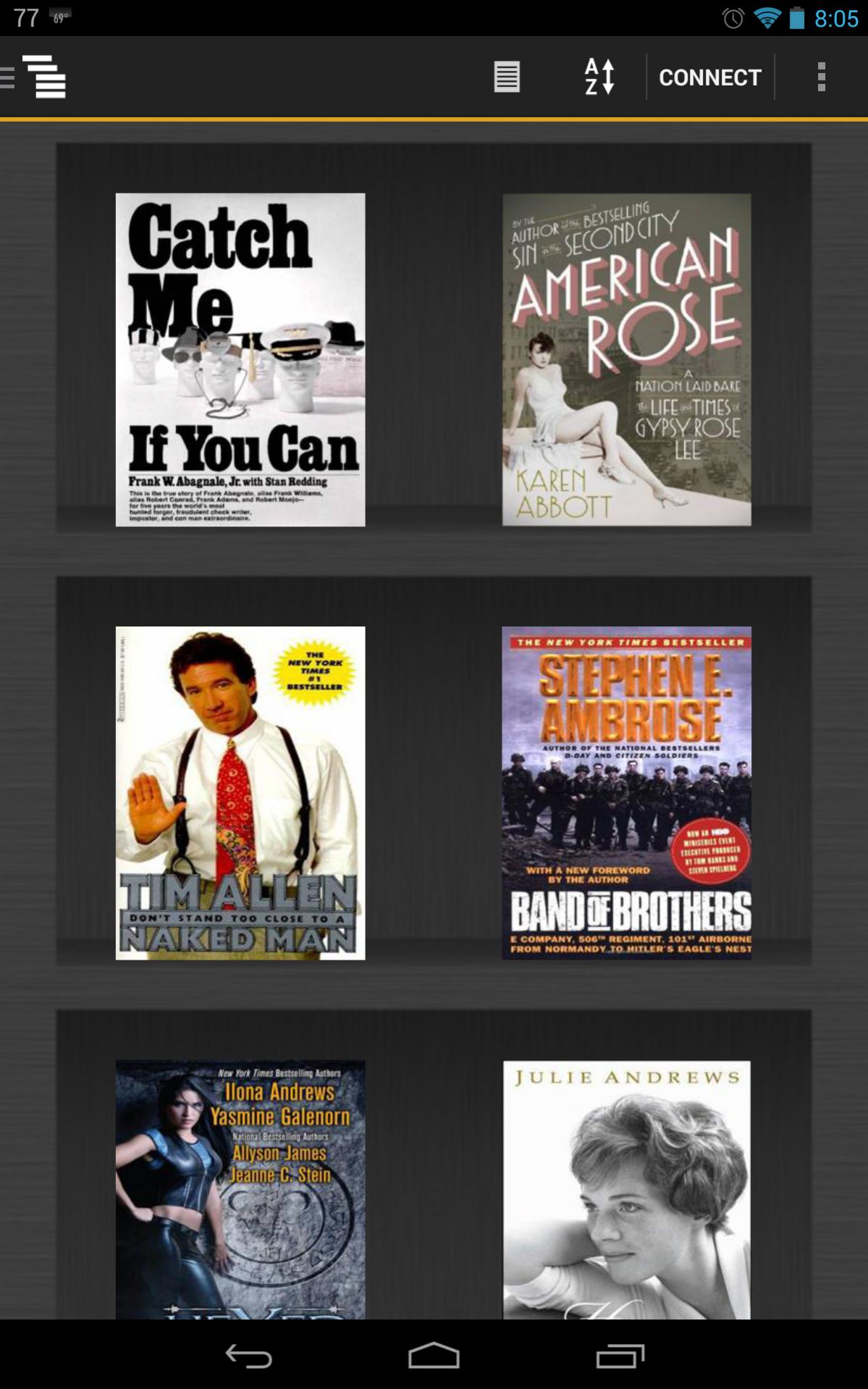

3.2 has a minor bug that was not in the last prerelease. When I select any grouping from the drawer the title of that grouping does not show up next to the drawer icon. But if I go to Search and clear an empty search the grouping title appears next to the drawer icon as it always did.
Debug log sent.

If the group info goes away only after going to book details or the content server, then I can reproduce the problem. Is that the case for you?
EDIT: I just got the debug log from Steven, and it confirms what I think is happening. FWIW: I will get the logs faster if you change the address to send them directly to me. Use the address cc_debug_log at charles dot haleys dot org. Or not ... Steven will forward them to me as soon as he sees them.
It does go away after Book Details, but it also goes away any time I change groups and does not appear again until I bring up search (an empty search) and press clear.
I'll clean the database then reinstall fresh and see what happens.

@DoctorOhh: I see a lot of orientation changes in that debug log. Are you actually changing the orientation? If not, then I have another mystery to solve.
With further examination of the debug log, I think that my fix will take care of the disappearing text problem even in the case that I can't directly replicate. There appears to be some android-version-specific stuff going on, but the change will deal with it.

I hadn't noticed this problem until I read this thread but I can reproduce quite easily. Phone is in Portrait throughout.
  • Slide or press top left button to expose Groups browser.
  • Select a subset of books e.g. click on my tag called 'Crime'. The text Tags:Crime is displayed next to top left button.
  • If I slide-close the browser to return to cover view then the Tags:Crime text remains in-situ. However, if I click the top left button to close the browser (instead of sliding), the text disappears.
Android 4.0.4 BTW
