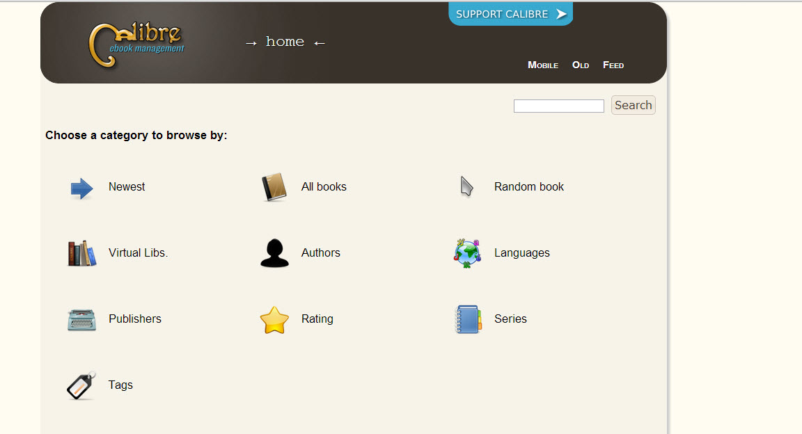

Hello,
Is it possible to remove some categories from the web interface for calibre?
For example, if I don't rate my books in calibre and I'd like to remove that category from appearing when I log in to the content server on my LAN - is it possible to remove categories from appearing in the web interface?

Hello,
What is the name of the tweak I'm looking for? I can't find it, sorry.
Is there any special code I need to input in order to remove a certain category from showing in the content server? Is it "ID: content_server_will_display"?
content_server_will_display = ['*']
content_server_wont_display = ['#rating']
Could you help me to understand what I need to tweak? Thanks!

Thank you for that chaley! I'm still having a problem, please see below.
Rating is still displaying in my content server, even after several server restarts.
Thanks!
______________________
# Set custom metadata fields that the content server will or will not display.
content_server_wont_display = ['rating']

I see now.
When Kovid mentioned (in #2 reply above) "tweaks" I figured it was something I could do manually, regardless of whether or not it was concerning a "default" column. But now I understand what you guys mean.
Do you happen to know if there is perhaps any chance of this option being in a future update? I wish I could make my columns nice and neat, but there is one straggler down there lol (tags)
I can't customize my content server currently,
Thanks for any feedback.
