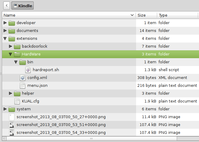

This is a corrected and extended function button for reporting the K5 hardware environment.
  • Fixes some typo's in version 1.0
  • Reports on the hardware board details (for troubleshooting things).
  • Reports on the battery condition from the kernel's /sys/devices tree.
Tested on Kpw, should also work on Kindle Touch but not tested.
Un-archiving the zip file will create a directory 'HardWare' with contents and a sub-tree (same as other KUAL buttons).
Copy the 'HardWare' folder, and its sub-tree into your */extensions directory for KUAL (same as other KUAL buttons).
If you should find a file named: '1' in */extensions/HardWare/bin, that file can be safely deleted. It is the result of the typos in version-1.0.
Titled as a "KUALette" because there is no 'upstream source' - its all scripting, what you see in the files is all there is (plus the lab126 functions it calls).
Hardware Version Report
  Board: celeste
  Revision: 22
  Platform: yoshime3
Battery Status Report
  Battery ID: 10
  Battery capacity: 99%
  Charging voltage: 4190 mv.
  Charging current: 112 ma.
  Current charge: 1376 maH.
  Last measured discharge: 1386 ma.
