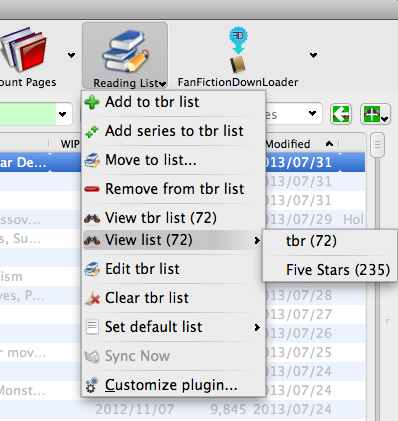

mh not sure you can see it there, but you can easily see all your lists like this, as I do (not sure if there are more ways)

Most people just add appropriate tags (or a custom column) to maintain this sort of information.
The Reading List plugin helps with maintaining lists of books that need to be synced to the reading device at some future point in time.

oh, right, I suppose you could also create a custom column (comma separated text like tags), instruct the plugin to add a specific tag on that column when you put a book on a specific list, and you'd probably have what you want, the lists showing on the left side (I have not tried to do it but it should work)!
