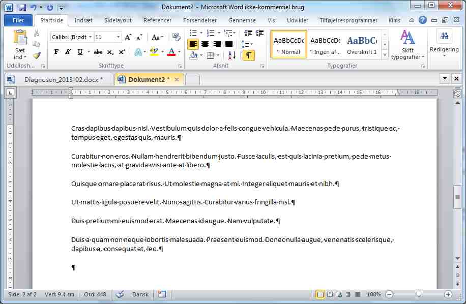

Originally Posted by Johneltin View Post
Yes - exactly - I am highlighting in 'Word' - copy - paste into Sigil. It all works fine except for the extra line space.
Are you making spaces between paragraphs in Word using an extra paragraph instead of setting the paragraph spacing in the style?
If so, the extra paragraph will (of course) show up in the copied text in Sigil.
In Word (with the "Show/Hide formatting marks" set to "Show") the Word source should look like this:
https://www.mobileread.com/forums/att...1&d=1374007724
and definetely NOT like this:
Regards
Kim
https://www.mobileread.com/forums/att...1&d=1373975430
I think you have those samples the other way around.
Oh c... - I think you're right - that they're wrong
I've corrected the blunder ...
