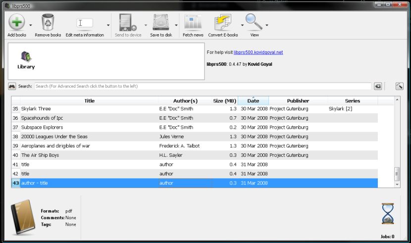

However, actually importing that same file into the library displays the following:
Title: "H.P. Lovecraft - At the Mountains of Madness"
Author: "H.P. Lovecraft"

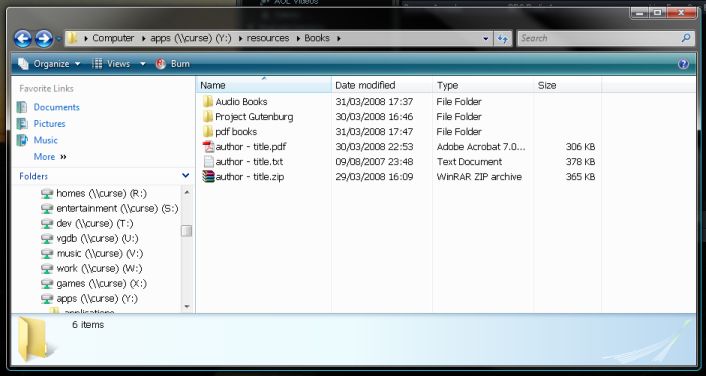

Upon further investigation it only seems to do this with PDF documents; the author and title fields seem to map correctly against html, zip and text based files.
So if I rename a pdf, an html file, a text file and a zip all to the same name:
wibble - wobble.[pdf|zip|txt|html]
...then the html, text and zip version of the file will all correctly display as title="wobble", author="wibble".
However the pdf file will show as title="wibble - wobble" and author="wibble".

Is this right though? I've attached an example of the difference in behaviour with the same filename for three different file types. There is no metadata set in the PDF file.
ID:	11895   Click image for larger version

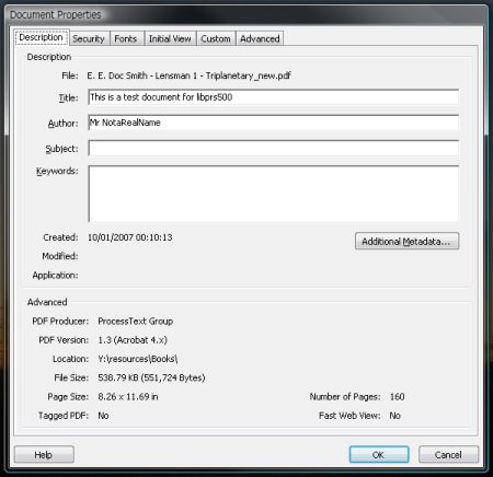

No metadata to start with. Metadata added with the following command:
pdftk E.\ E.\ Doc\ Smith\ -\ Lensman\ 1\ -\ Triplanetary.pdf update_info metadata output E.\ E.\ Doc\ Smith\ -\ Lensman\ 1\ -\ Triplanetary_new.pdf
The metadata input file is trivial:
megatron@curse:/export/Apps and Resources/resources/Books $ cat metadata
InfoKey: Author
InfoValue: Mr NotaRealName
InfoKey: Title
InfoValue: This is a test document for libprs500
Then check the metadata with pdf-meta:
megatron@elderthing:/cygdrive/y/resources/Books $ pdf-meta.exe E.\ E.\ Doc\ Smith\ -\ Lensman\ 1\ -\ Triplanetary_new.pdf
Title : E. E. Doc Smith - Lensman 1 - Triplanetary_new
Author : Mr NotaRealName
Publisher: None
Category : None
Comments : None
ISBN : None
The Author is displayed correctly, but the Title should be "This is a test document for libprs500"... (as shown in the screengrab of Acrobat below). libprs500 therefore still displays the incorrect Title.
File Type: pdf E. E. Doc Smith - Lensman 1 - Triplanetary_new.pdf (538.8 KB, 1374 views)
Megatron-UK is offline   Reply With Quote
