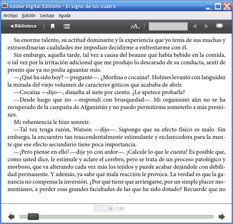

My version is ADE 2.0.67532. But also should work in ADE 2.0.67275; maybe you are doing something wrong. Have you downloaded and installed the dictionaries for "Hyphenate This"?
Below I attach a screenshot of my ADE.
EDIT: A dummy book with just one word is not enough to see hyphenated words. Instead use a real book; "Hyphenate This!" won't hurt it.
