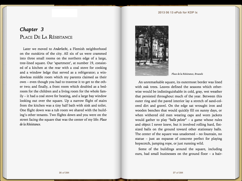

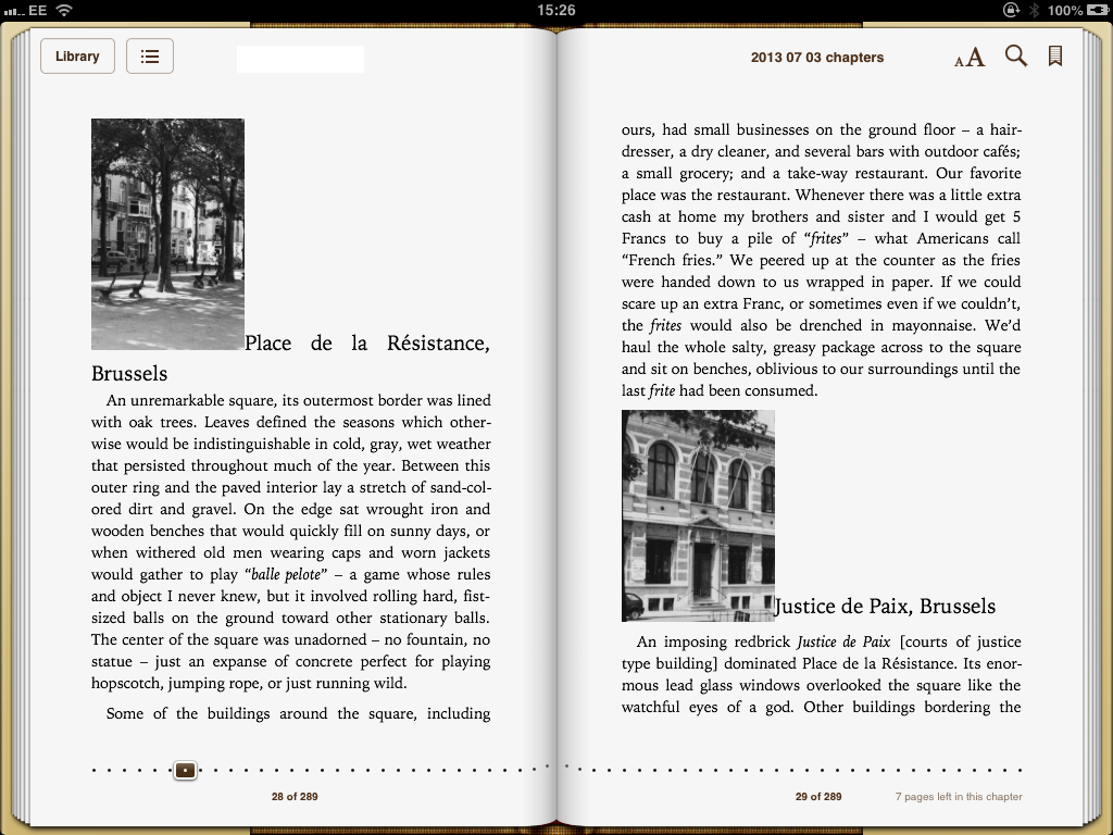

Hi, I'm trying to improve the formatting of my picture titles, but not having much luck.
Attached file shows how captions are currently appearing.

You have the picture inline with the text in the same paragraph. You need to get the picture into a separate paragraph by itself. Another choice would be to so a shift return (<br /> between the picture and the caption.

I'd hoped to keep text alongside photo - the same way it appears in mobi, print, and ePub as originally exported from Pages (see attached). For some reason, this problem has only arisen since opening in Sigil. Hence choice of forum.

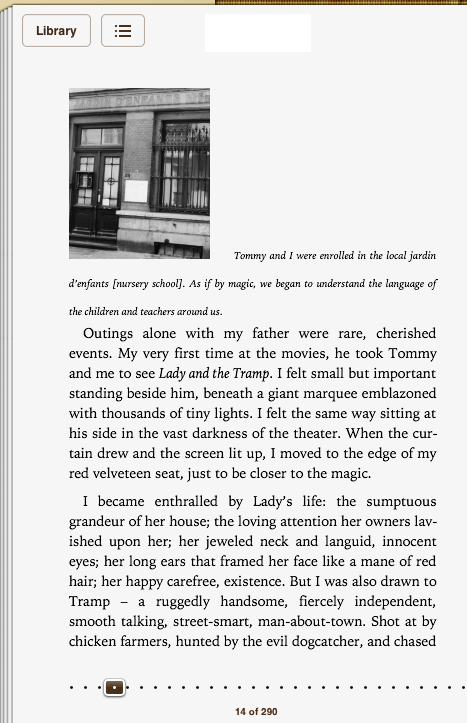

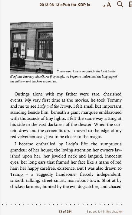

Just one small problem: the line spacing for s8 appears to have increased, despite the fact that it's defined (in your code and mine) as zero.
I've attached the spacing I'd like, (which comes from Pages/export-->ePub), and the current spacing after editing as per your post.
