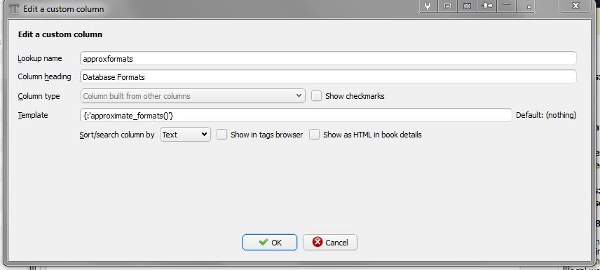

epubfan - suggest you do a search on approximate_formats to see what its all about - its a function rather than a column - you'll need to create a custom column - see attachment

The column I refer can be added via Preferences | Interface | Add your own column
Lookup name:    approxformats
Column Heading: Rough List of Formats
Column Type:     Column built from other columns
Template:          {:'approximate_formats()'}

With the exception of format, these are database columns, the database is 'heavily indexed' in order to make searching and sorting fast.
However, 'formats' refers to the extensions of files in book folders, hence a search (or sort) must crawl through the library folder tree looking for files whose extensions match the search term, which is slow.
But, 'approximate_formats()' refers to a derived list of formats that you need to put in a custom database column which will be fast for the same reasons other database column based searches are.
See the link that Peter T posted for a discussion of why & how the function came to implemented. And see http://manual.calibre-ebook.com/temp...ximate-formats for definition and caveats
