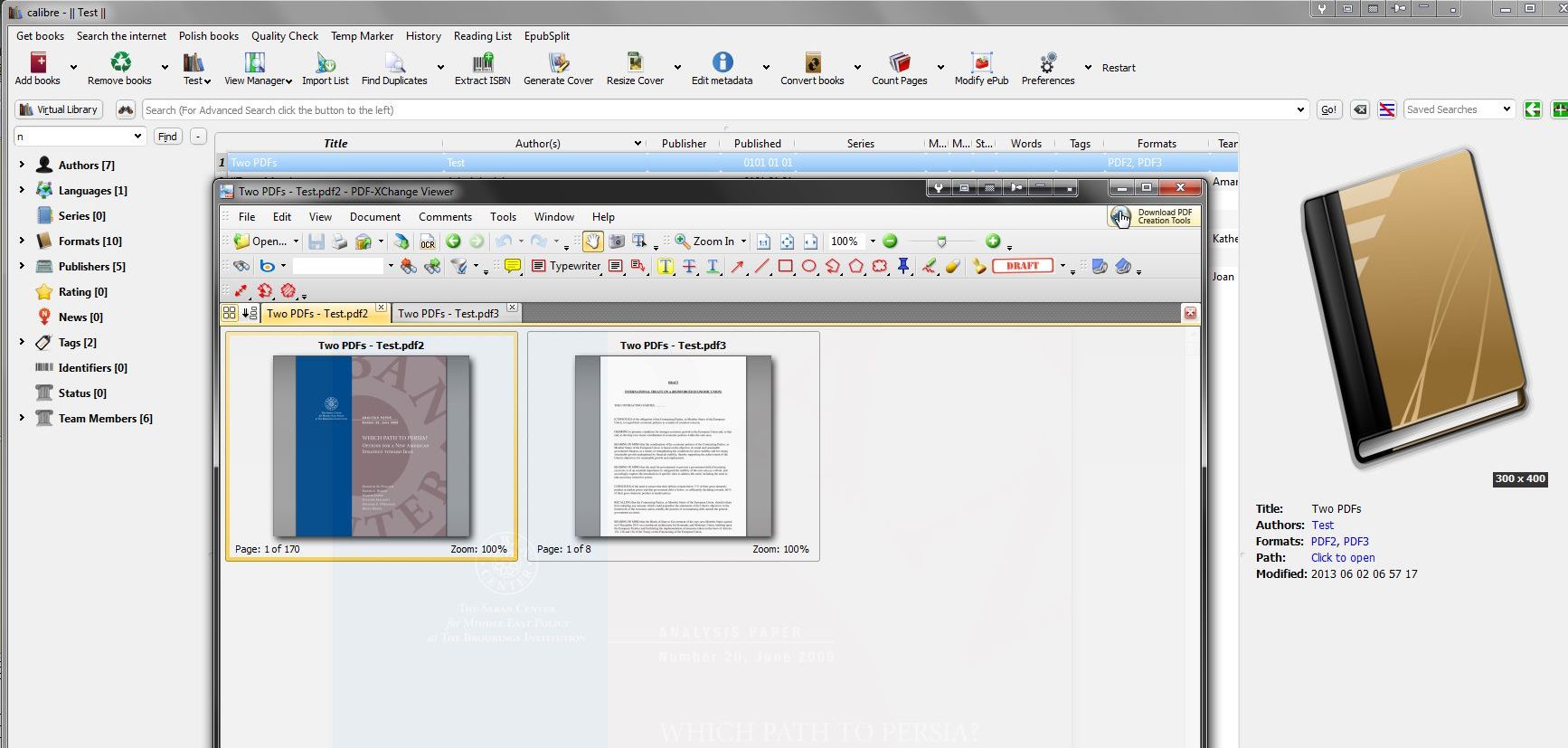

You must add the file(s) via Add Books->Add Files to selected books
You may have to select All files in the Mac open file dialogue, on Windows its set to show known ebook file types only
Attachment shows example of two completely different pdf's in the same book folder
