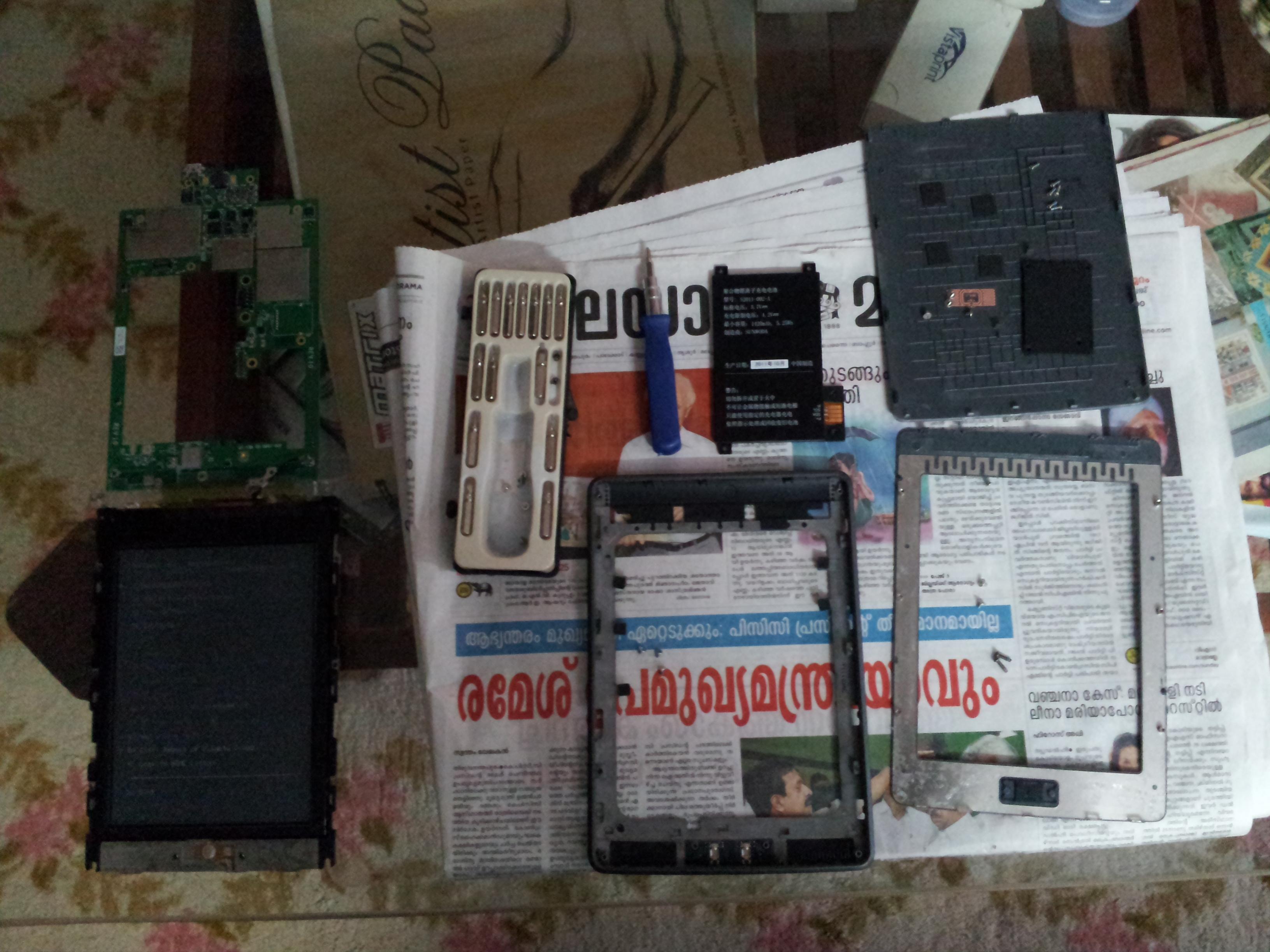

Just had a look at the hardware!
Was surprisingly very easy to take apart. Didnt really need anything much other than a philips screw driver and a thin flat tool to wedge it open.
I'm probably going to have to change the motherboard and/or screen by trial and error. Now to obtain spares...

Looks a lot like the teardown indexed in our master index:
http://www.techrepublic.com/photos/c...h-2011/6330940

That was likely more professionally done!
Mine was a lets try take it apart and see what happens...but turned out to be surprisingly easy. Though I did bend 1 clip a little in the process.
