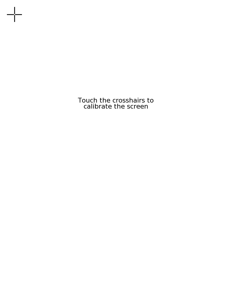

Stylus Calibration Easy Installer
For those who haven't been following the efforts of Jayk, jhaker, Matthijis, and others here (login required) and here -- we now have a working calibration solution for the iLiad!
I've taken their work and compiled it into an easy installer for everyone. It has been tested on my personal iLiad as well as two others without problems. However, as it copies files to the root filesystem and updates start.sh, there is always a risk involved.
To install:
  • Unzip the File
  • Copy it to the iLiad anywhere you'd like
  • Run the installer
  • Use the power switch to turn off and then turn on your iLiad
  • Browse to the Notes folder and run the "Calibrate Stylus" script.
You will need shell access installed in order to do this.
Edit: Attachment removed as bug was found in software. New update to follow shortly.

[Edit] Adam B., can you post a larger screenshot? I can't read anything on the posted on.
[Edit II] I can read it now.

Not much to see. Just a standard calibration page.
I'm glad it's working out. It's definitely a must have for anyone who takes notes. And since 2.9.10 is feature frozen, you probably won't see it officially from iRex for a while.
