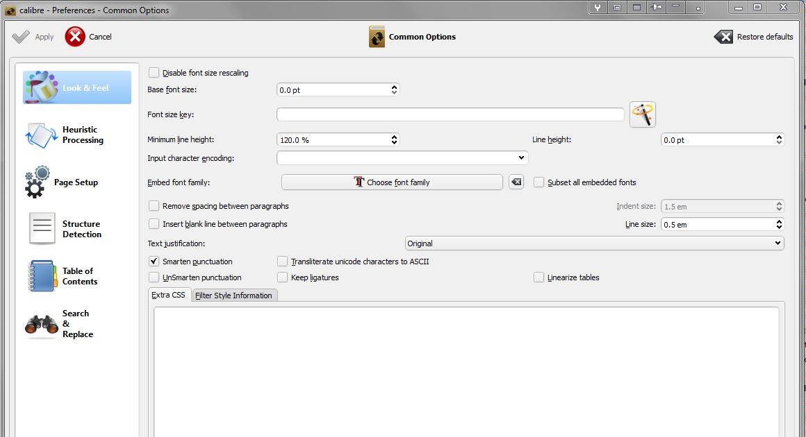

Works fine here
Preferences->Conversion->Common Options->Page Setup->Output Profile I've found the best for RTF Output is Generic Output Profile
Turn Heuristics off, see attachments for other settings
If you're opening the RTF's in Word check the Document Template that's being applied, OOo has something similar but it may be called something different

Thanks for the screenshots. Looks like my text justification had somehow changed to justified. Maybe I had misclicked sometime.
Anyway, changing it to "original" makes processes the RTF output as expected.
Thanks.
