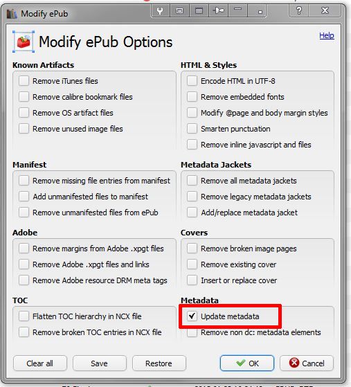

Originally Posted by bensheimer View Post
On the Plugin, do I have to set any options in it? Do I have to use it or will just installing it will solve my problem.
Thanks
bensheimer run it after updating your metadata, make sure you tick the box as per attachment - you can run the plug-in on multiple books
