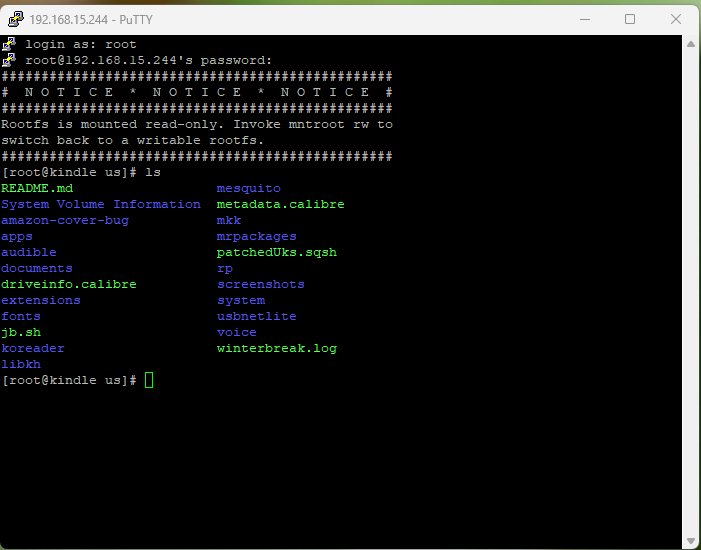

USBNetLite works for me. Installed it, entries showed up in KUAL menu, enabled it, connected the Kindle to my computer over USB, set the matching network interface on the computer to 192.168.15.201 to be in the same Class C subnet as the Kindle's interface. Opened Putty, set the address, etc. to use to 192.168.15.244, port 22, SSH and connected. Logged in with the default credentials and no problems.

Installed USBNetLite and enabled it from KUAL. Connected to my computer using a USB cable (as the name suggests this is a network connection over USB). My Kindle was detected as a network device and the driver automagically installed (shows as USB Ethernet/RNDIS Gadget in Device Manager). Set the IP address of that adapter to 192.169.15.201/netmask to 255.255.255.0. Open PuTTY and connected to 192.168.15.244 using SSH. Entered the default username and password.

Name:	Screenshot 2025-05-30 222656.png
kindlebrowserorientation
