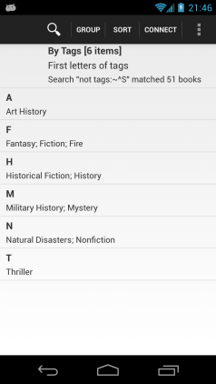

The next screen shows what happens if I tap "Not matching", which finds all books without a tag beginning with "S". The header now has a "not" in the search string to tell you what it is doing. Note that there are no longer any "S" tags in the list, which is good because we asked for books with no tags beginning with "S".

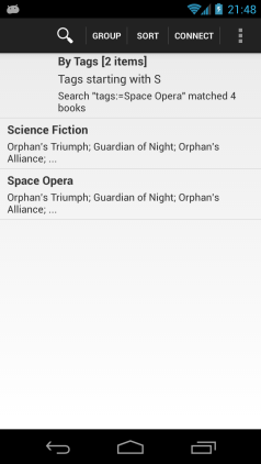

I then long tapped on "Space Opera" and chose "Match", which selected all books with that tag. All my books with the tag "Space Opera" also have the tag "Science Fiction".

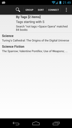

The last screen shows what I see if I chose "Not match". I see all the books that do not have the tag "Space Opera". Note that the list of books with the Science Fiction tag is different from the screen shot above, because it is now showing books with "Science Fiction" but without "Space Opera". The non-fiction tag also appeared.
