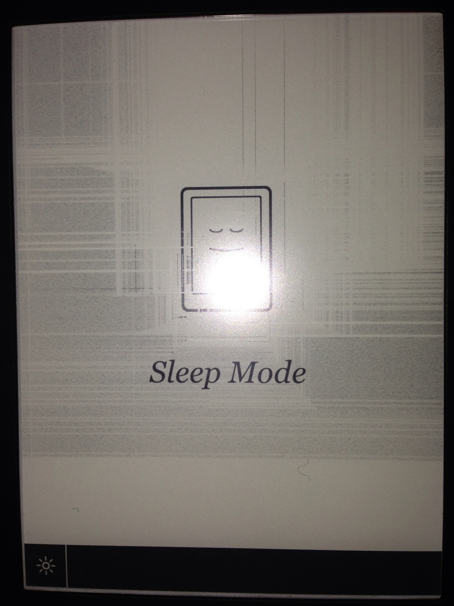

Thanks for the advice everyone. Have tried everything mentioned above, to no avail. Here is a picture of what the screen looks like:

I've just realised I have no idea what I'm doing when adding photos. Sorry if that's wrong. And I know it's sideways!
Nothing I do can get it to move from this state. The little light flashed blue at me for a while when trying the factory resets, but nothing happened on the screen.
I can't imagine how I've broken it. It was fine when I put it down on the 23rd, then this...!

That looks more like a controller (hardware) problem than a broken substrate, so you might want contact Kobo for warranty repair on it.

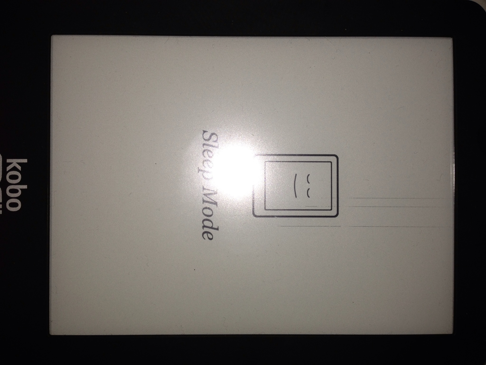

Ok so I got a reply from Kobo, asking me to perform a factory reset using a different method than those above (hold light button, press reset button, release light button when LED turns white). I did this, and thought nothing had happened. Went to try again, just in case, and as I pressed the light button, it came on! And stuff got weird...

Again, apologies if the picture doesn't work correctly!
The light bar appeared, but is not responsive. I can turn the light on and off, although it does not always work.
I'm surmising from this that the issue is indeed the screen?

Tough to tell for sure. The straight lines would suggest a hardware controller problem, but if you look above and to the left of device picture on the screen there looks like there is a curved line and also at bottom left of it there is a diagonal looking line. That suggests broken substrate which likely won't be covered under warranty. Tough to tell since most of it is under the flash. I'd take a shot at getting Kobo to warranty cover it.
If it is a substrate break you can do a search and there are lots of posts explaining it and at least one with a tear down of a device so you can see what it looks like. In a lot of cases it is caused by twisting of the frame of the device, but yours is broken it looks more like a point impact/pressure likely under where the flash is on the 2nd picture (guessing at that from the position of the two possible breaks).
