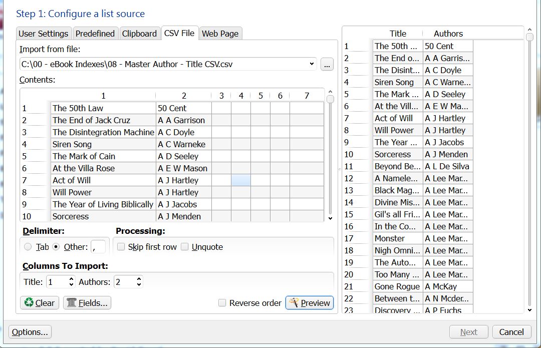

@MontyJ - can you post a screenshot? Clicking the Preview button so that you can see some rows from the file displayed on the right side should be all that is required to enable the Next button of the wizard.

Old 12-08-2012, 10:52 AM   #11
MontyJ
MontyJ began at the beginning.
Posts: 224
Join Date: Jul 2012
Here it is.
MontyJ is offline   Reply With Quote

Very interesting. Looks like you have done everything correctly, so there must be a bug in there somewhere. Any chance you could PM or email me the file? Just zip and upload it somewhere...

Kiwidude,
Just for a lark, I took the first 23 records from this file and made another .csv file with only those records; I am able to get to Step 2 using those 23 records!
So, it appears as tho there is a bad character/symbol somewhere in this file. I will look at my export settings from OOO Calc and see if I use quotes or some other setting if I can negate the error.
MJ
[Edit] I did an export from my ODS spreadsheet file with quotes (" ") surrounding all text in the two fields, and using a TAB as delimiter. I do have commas n the title fields, so I thought that may have been causing the hiccup somewhere further down in the .csv file. But even with the fields quoted and using a TAB as delimiter, it still hangs...
[Edit] I split the .csv file roughly in two; authors A-J, and then the second half K-Z. The first half works ok and lets me go on to Step 2, but the second half still will not. So if it is not something to do with the number of records, then it must be a bogus character in the K-Z file.

Kiwidude,
Ok, found a couple blank records in the k-z csv file. Once I got those cleaned up, all is well and I can get on to Step 2 with the entire a-z csv test file. When I checked the original ODS spreadsheet file, there are NO BLANKS. That means there is a bug in the conversion output to CSV...
