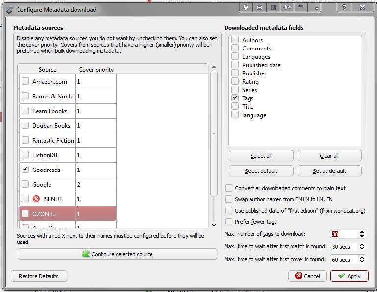

Have a look at Configure Metadata Download - I think it will allow you to restrict to Goodreads Tags Only - sample attached

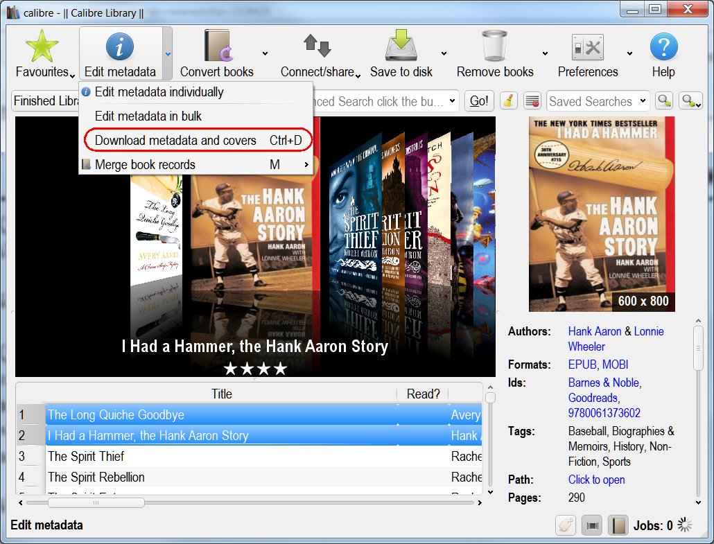

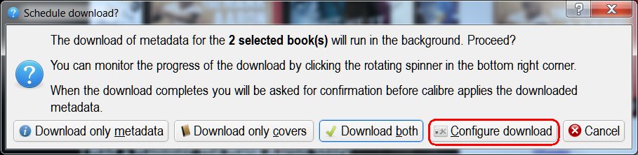

Having now deleted all the tags in my library and wanting to use the installed plug in to refill the tabs from Goodreads, what are the mechanics pls to solely group process only the tabs? i.e. I don't want to have overridden any of the other fields, such as author name when using "Edit metadata in bulk", and haven't yet found a way.
When you select the dropdown arrow next to the edit metadata icon select Download metadata and covers. Then select configure download. Now uncheck everything except tags, see attached images.
Good Luck.

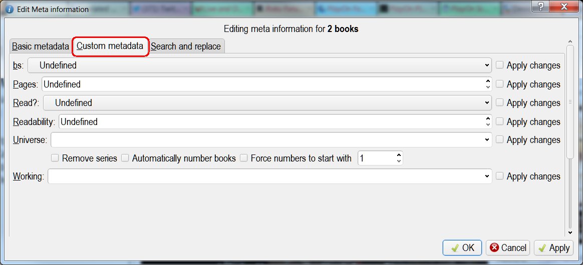

Once you create the column you might be missing seeing this tab too (see attached). Select whatever titles you want and update the category for all selected via the edit metadata window as I tried to indicate in post 2.
This is why I'm confused, I think something along the lines of the second link I sent you to in post 6 is what you're looking to accomplish (ignore the sub-groups if that is not what you want.
