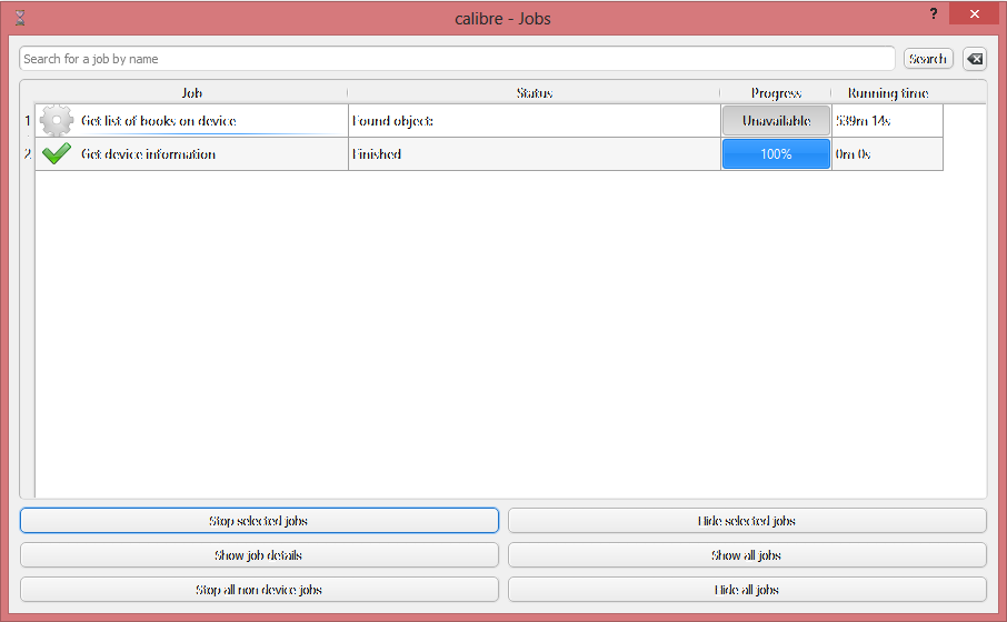

I haven't seen any threads about this yet so I guess I'm first. I've seen the threads concerning MTP-only devices taking a long time connecting to Calibre by USB. However, my Sprint Galaxy Nexus (toroplus) has been connected for 608 minutes now and is still not done. This didn't happen in Windows 7 which leads me to believe that Windows 8 handles MTP differently than 7 did. I also have another program (ComicRack) that seems to have a similar issue and there's no fix there yet either. I just thought that I should bring this to the attention of the people here just in case there's something I'm doing wrong.
The attached image is a screenshot from over an hour ago showing 539 minutes of connection time listed in the 'Jobs' window.

One thing you can try is rebooting both your device and your computer. That resets both MTP stacks and often fixes this kind of issue. Unfortunately, I dont currrently have a Windows 8 system to test with, so I can't comment on whether the problem is generally present with windows 8 or not.

Oddly enough, this actually worked (for Calibre at least). Thanks for the help ^_^
