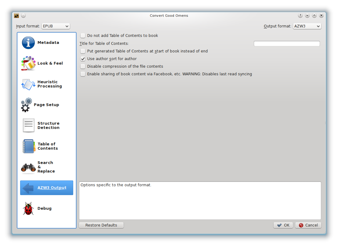

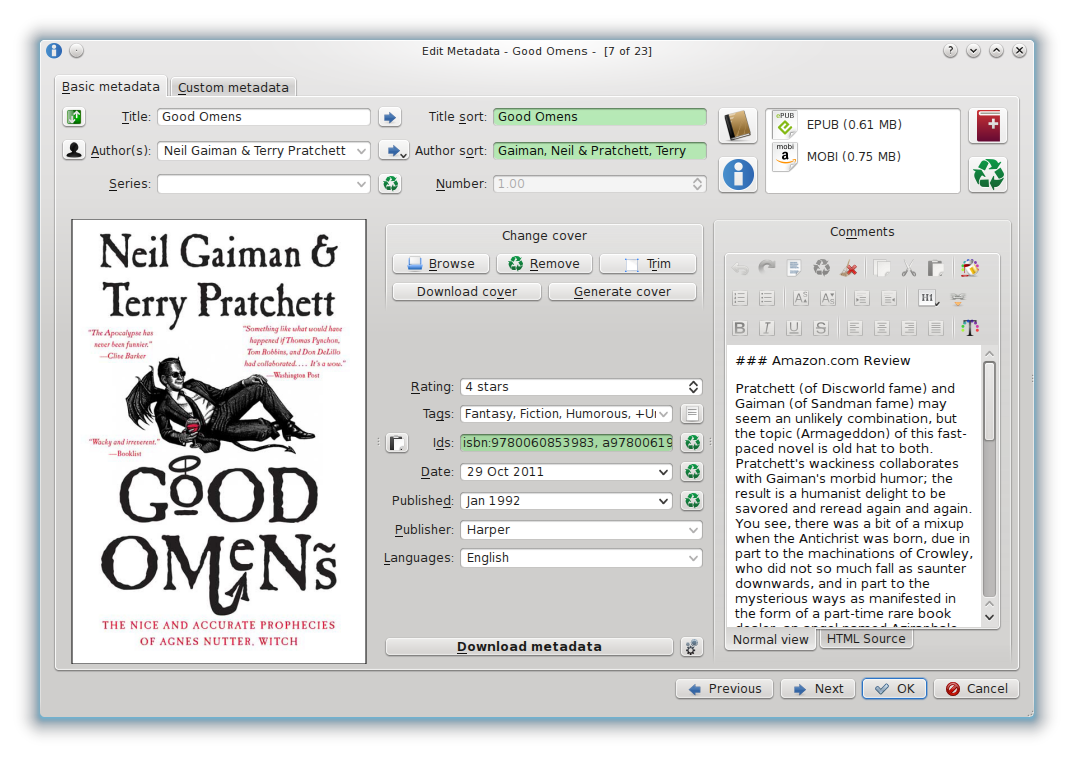

The very effective solution Calibre came up with to still keep pretty 'FN LN' formatting in the author field, and thus in Calibre's UI, is the 'Use author sort for author' setting in the MOBI output settings: you get to keep sane metadata on Calibre's side, and the Kindle gets a file with metadata it likes, and gets sorted properly on the device.
TL;DR:
author: FN LN
author_sort: LN, FN
MOBI output settings: Use author sort for author

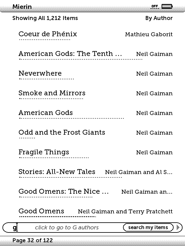

@heeby: They're *shown* as FN LN on the Kindle, but they're sorted by LN (when sorting by Authors, that is).

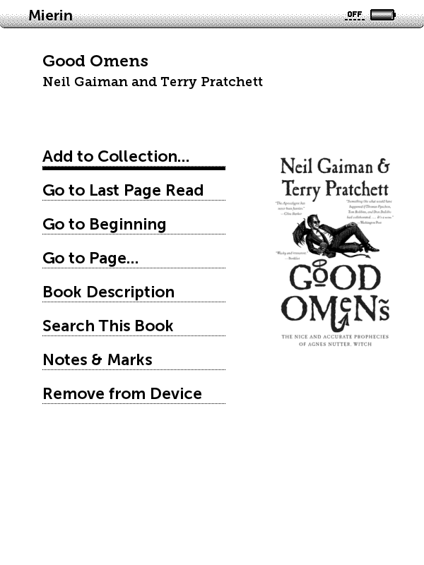

@heeby: There's a quick way to check, but I have no idea how that works on the K4, since it lacks a keyboard:
Home screen, sorted by Authors, Go To > G [or just type G on older devices], that should jump to the page with authors whose last names begin with a G.
And as a picture's worth a thousand words, an example (showing that it even works with multiple authors):
(That's a screenshot of an individual book convert setting page, but you probably want to set it globally, in the Preferences).
Home screen, sorted by Authors, Go To > G [or just type G on older devices], that should jump to the page with authors whose last names begin with a G...
The K4 handles it by requiring you to select the 'return' symbol (the bent arrow) on the software keyboard after selecting the letter you want to jump to.
And yes, both my K3 and my K4s have my authors sorted by LN FN, although they are displayed FN LN.
