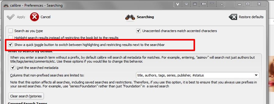

Help - now there is not a bars button at the end of the search bar where has it gone?

Posts: 22,042
Karma: 30277960
Catch 22
see attachment
Catch 23 is read 1.11 release notes

eschwartz
Ex-Helpdesk Junkie
eschwartz's Avatar
Posts: 19,421
Karma: 85400180
Join Date: Nov 2012
It has been moved to Preferences ==> Searching, check/uncheck "Highlight search results instead of restricting the book list to the Results" as of calibre 1.11
http://calibre-ebook.com/whats-new:
Release: 1.11 [15 Nov, 2013]
Remove the button to toggle search result highlighting from next to the search bar, as too many people click it accidentally and then do not realize what they have done, despite the confirmation message that pops up. The button can be restored via Preferences->Searching
