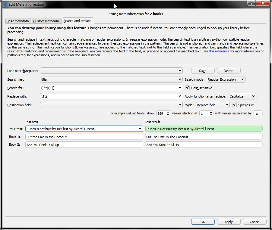

My fault -- I "improved" the regular expression when I posted without actually testing the improvement, and of course the change broke it.
Use "(.*?)( |$)" in "Search for" and "\1\2" in "Replace with". NB: This regexp produces incorrect results when a title contains multiple spaces in a row.
This screen capture shows what it does.

Wow thanks chaley that did the trick, so can I use that method to check and change my whole library in one go or should I just use it on a few titles at a time?
Oh and one other thing, what exactly do the regular expression symbols mean and how would I have known to do that if I hadn't asked on the forum... not really important now I know but I am curious as to how it works.
