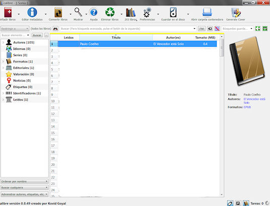

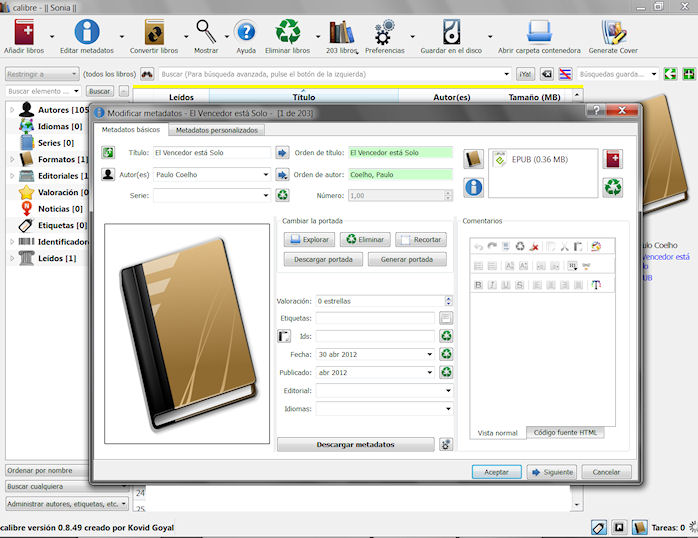

I have a problem with the Calibre and I don't know how to solve it. Before when I added a book to the Calibre and the book has the cover included, automatically you can see the cover at the right side. (See Image 1). Now I see a brown book. Also, if the book has the cover included, in Edit metadatos section, you can see the cover. Now I see a brown book. (See Image 2) In Add Books section I have marked the option to read the name of the file. How I can resolve that? Thanks in advance.

When you read metadata from filenames, covers will not be read. Use the bulk metadata edit dialog after the books have been added to read the covers from the added book files.
What do you mean as bulk metadata?
How I can do what you are explaining to me?
How I can get that when I add a book Calibre don't read the metadatos, but create a cover, since the cover is created from the front page of the book, as much as if it is an image or it is a text?
Thanks.
Dariarb is offline   Reply With Quote
Old 05-05-2012, 01:18 AM   #14
Posts: 45,664
Karma: 28549046
Right click the edit metadata dialog and select bulk edit metadata
