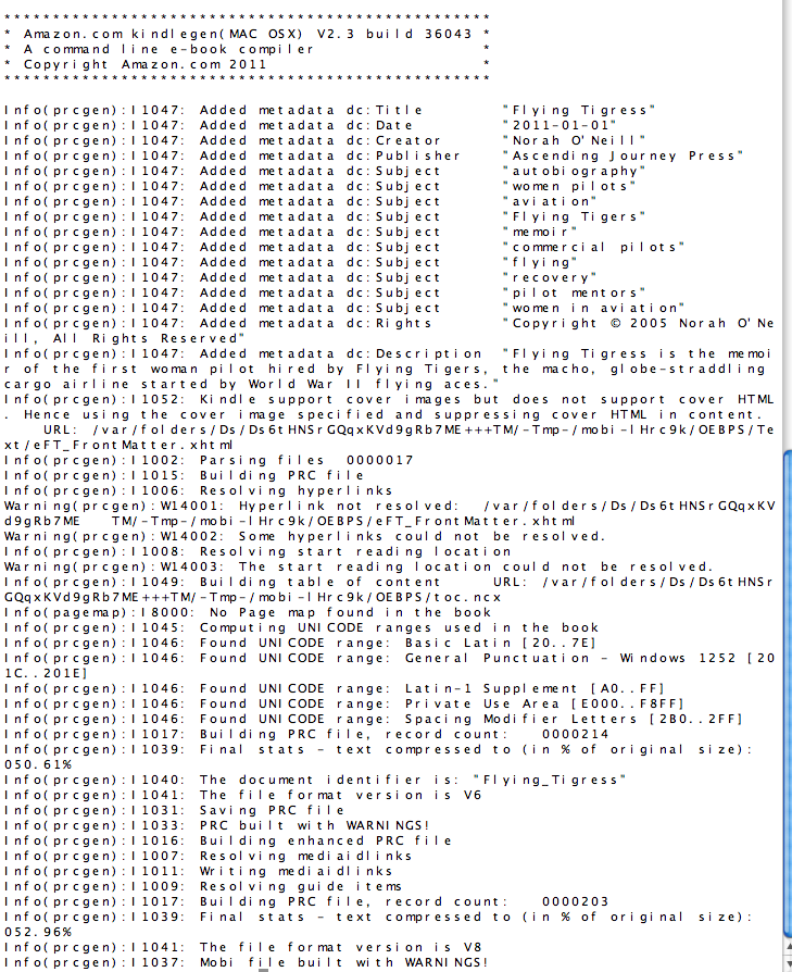

I am attaching a screen shot of the info generated from KindleGen. I haven't changed anything else in the file and now the hyperlinks aren't working?

Old 03-06-2012, 01:36 PM   #6
novation
novation began at the beginning.
Posts: 13
Ah! Got it. The title in the Section0010 file was incorrect. All is working now.
