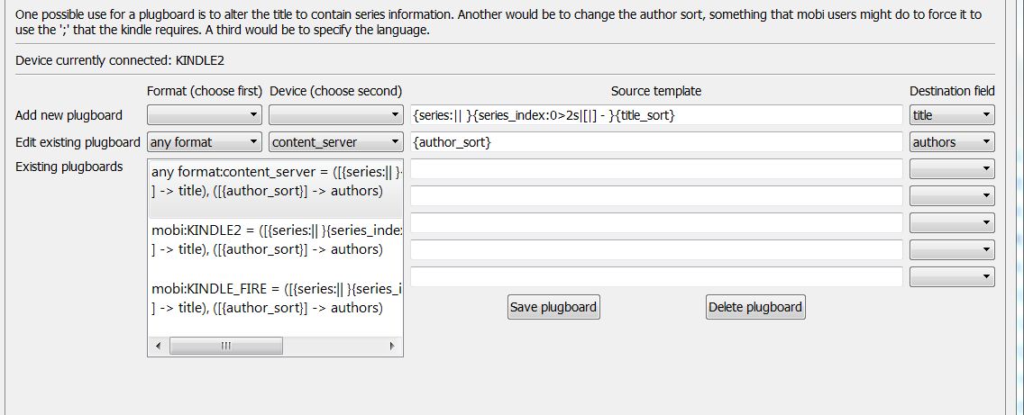

thanks for your quick response --- however, I've set up the plugin, and there is no change - the data in the content server looks the same and when i "get" a book either thru my KK or download into my computer, there is no difference. I shutdown both Calibre and the content server in the background and restarted both, then shutdown the background server, and started it within Calibre -- nothing seems to have an impact.
Am attaching a jpg of the plugin I setup.

The plugboard does not affect the data shown in the content server. Only the metadata in the ebook files served by the content server. Download an epub or mobi file from the content server using your browser on your computer, open it with the calibre ebook viewer and check the metadata. And make sure you are running the latest calibre.

I did that, and can see no difference. I assume series/# are not considered metadata? I thought with the content-server plugboard I put in (and posted a snap of in this thread) would include the series/# as part of the title, but not as I can see after doing what you suggested. But, it that plugboard will change the title as seen in my content-server, maybe I don't want to do that -- I just want to see it work, tho.
