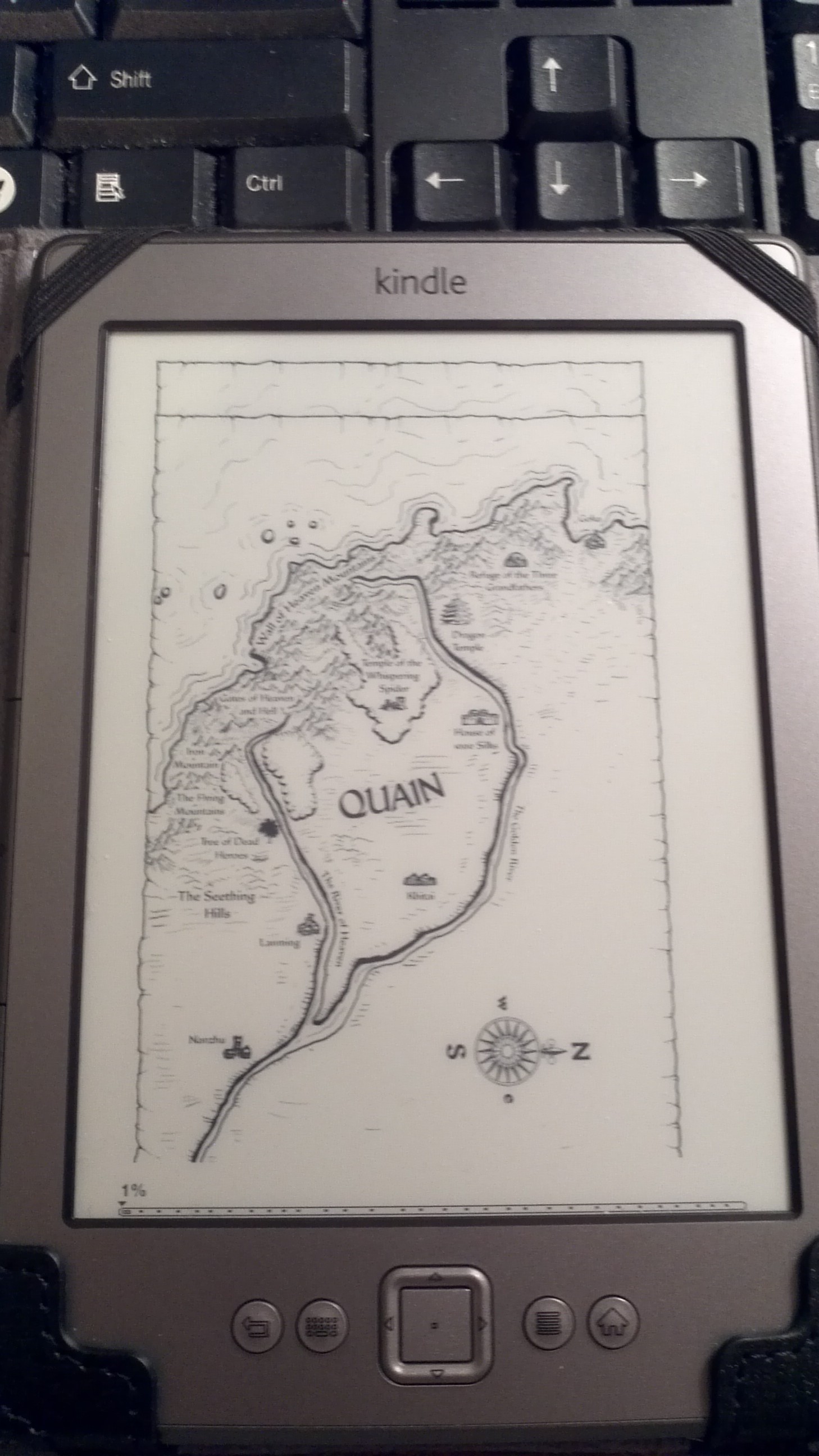

I bought an epub from Paizo.com and converted it to mobi using Calibre for my Kindle 4. The problem is on some of the images (not all), the top 10% or so gets duplicated and the bottom 10% gets cut off. I'm not sure why this is happening. Anyone have an idea? Viewing the mobi file through Calibre and the Amazon Kindle app for PC shows no errors.
I've included uploaded images of the problem as well.

This has been mentioned before. I don't remember the solution, but I think it is a K4 problem (have you done the Firmware update?)

Sounds like a Kindle bug, most likely related to the way the files are encoded (just a guess). You could try using Tweak ePub and open each file in some image manipulation program and re-save them. (back up the original before you do this). Different jpeg settings or even a different encoding library will probably make the Kindle happy with the final mobi.

Haha, ok the problem has been partially solved. I updated my Kindle's firmware and re-converted the file after making sure my ouput profile was set to "Kindle" (I did this through Preferences > Conversion > Common Options > Page Setup > Output Profile) Now I the cover looks normal (yay!) but the map page still has the error. Very strange.

Oh my goodness... So I used the "tweak ebook" option and edited the html for the map image. I renamed it, and edited the original image slightly so that it was also renamed and would be recognize as a new image. Converted it again and the map page looks fine! But now the cover is repeating again!
Thanks for all your help by the way. I'm going to try and alter the cover image as well and see if that changes anything...

Ok. I finally got the two images working. Reediting the cover didn't work like it did for the map. Instead, using the "tweak ebook" option, I located the cover image and saved it to my desktop. Then when converting the book from epub to mobi I had it use the saved image as the cover representation. Now both the cover and map are correct. Thanks again for all your help!
