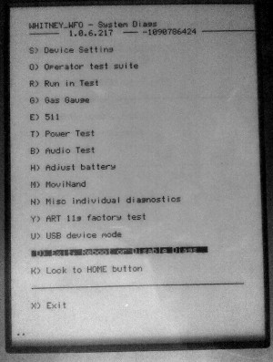

Uups. Something bad happend again: I put a file ENABLE_DIAGS like described in https://www.mobileread.com/forums/sho....php?p=1899652 and now my kindle displays permanently WHITNEY_WFO - System Diags. All topics are black on white but D) Exit, Reboot or Disable Diags is written white on black as if it is selected. Reseting to USB hid still works but there is no change to see on the display and I can not access USB disk anymore.
zepman is offline   Reply With Quote
Diags mode is able to run the data.tar.gz fix, but it needs a different payload destination and the run.sh must "mount /dev/mmcblk0p1 /dev/mmc" and then must make repairs inside /mnt/mmc/etc/* (or whatever else needs fixing).

Geekmaster, thanks a lot for your work. I understand: different mountpoints...
but my Kindle seems to be really dead, now:
Display does not change anymore. And my Ubuntu syslog shows
Feb 7 20:21:27 zeplucidhd kernel: [ 1907.120148] usb 1-2: new high speed USB device number 16 using ehci_hcd
Feb 7 20:21:27 zeplucidhd kernel: [ 1907.255649] generic-usb: probe of 0003:15A2:0052.000D failed with error -22
Feb 7 20:21:27 zeplucidhd mtp-probe: checking bus 1, device 16: "/sys/devices/pci0000:00/0000:00:1d.7/usb1/1-2"
Feb 7 20:21:27 zeplucidhd mtp-probe: bus: 1, device: 16 was not an MTP device
So I think i can not access USB/HID anymore. Or am i blind?
