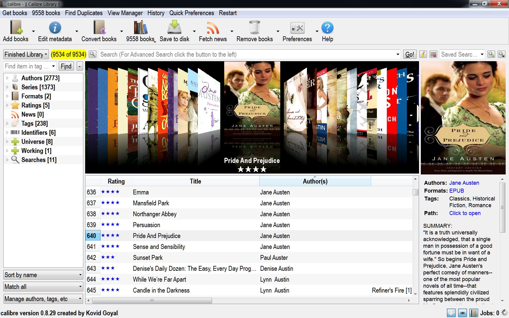

Originally Posted by mshnryman View Post
So turns out that "Find Duplicates" does work somewhat...its problem is in slightly varying book names because of how Calibre exported them.
The problem isn't with how calibre exported the books the problem lies with how you added them back to calibre.

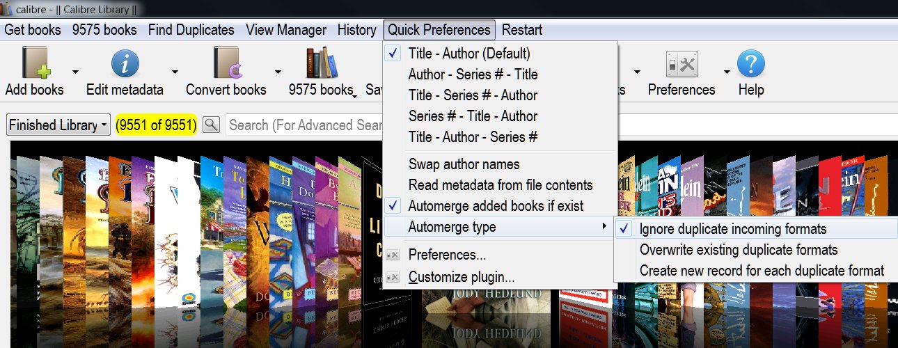

I use the Quick Preferences Plugin (see attached) to easily set the appropriate adding books settings and the appropriate regex for the books I'm adding.
Is there any way to make the search more broad (or another plugin) so that you can get a matching file list and then Alt+M them all? I tried "Identical, Similar, Soundex and Fuzzy" with little success. Also, I have no idea what the "Length" parameter is for...
You can make anything as complicated as need be, but in this case the user has to get the basic adding books steps correct to ensure the title and author are both not in the title field.

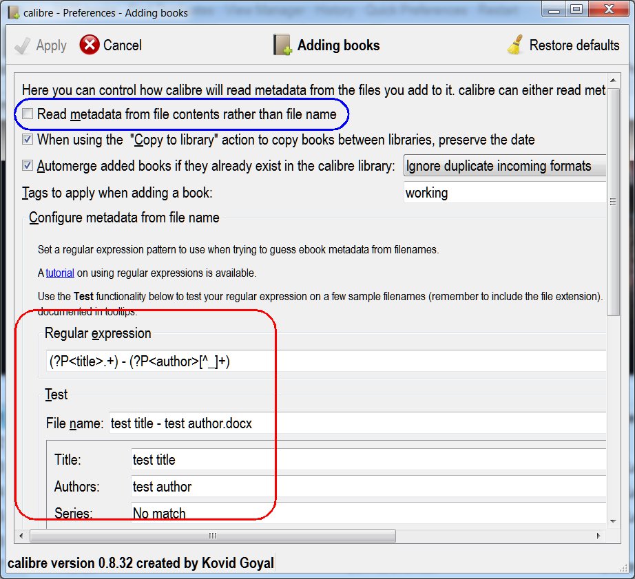

You say your file names are in the format title - author.docx and you have things set correctly the title will not be exactly as the filename.
My settings were already configured this way when I was re-importing the books back into calibre.
I doubt that they were set as you have stated, see attached. The check box in the blue area has to be unchecked. If you look in the red area you will see that I tested a book called test title - test author.docx and the proper title and author are parsed as expected.
I'm open to any ideas that I may have missed, but I already followed your "basic steps" to add books...maybe I missed the step of changing the behavior of "Saving books to disk" to "{title}" instead of "{title} - {authors}" before exporting them all.
I don't know what step you missed (or I forgot to document) but it should import the Title to the title field and the author to the author field.
Do you have the brackets {} around the actual names in the file name? Give me an exact file name as an example.
