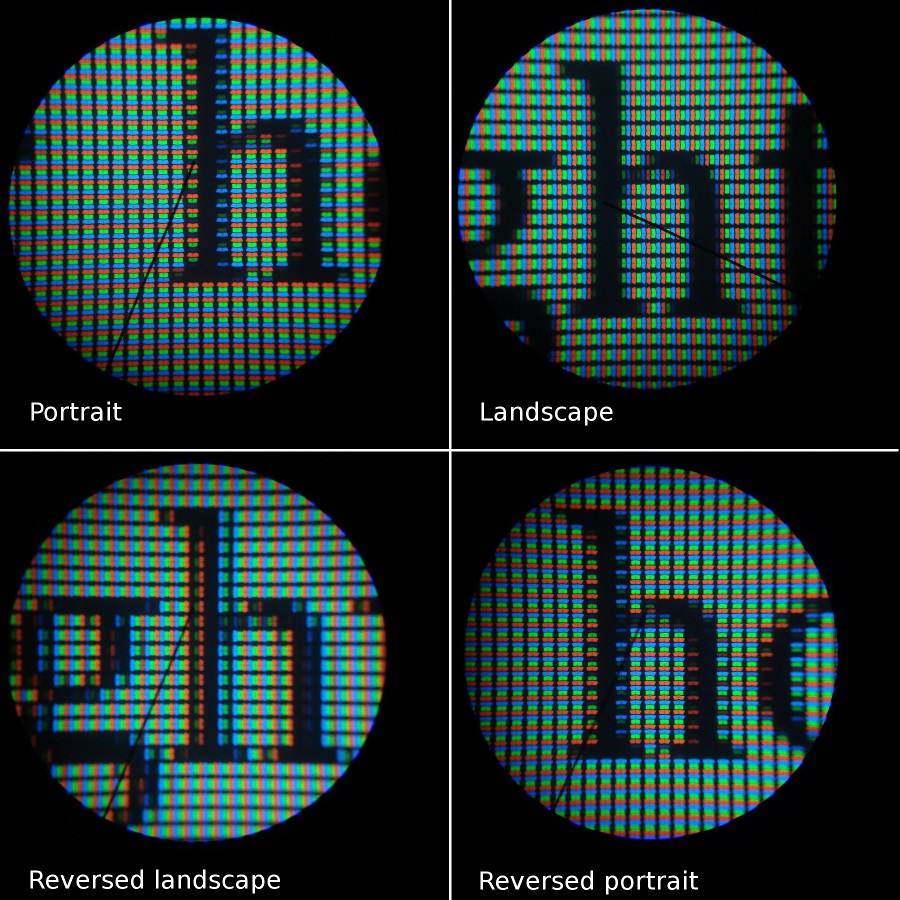

Kindle Fire subpixel rendering bug
I wonder if anybody else has noticed that the Kindle Fire's official ebook reader incorrectly does subpixel rendering in reversed landscape mode (landscape mode with the power button on the left).
The result is colorful shadows beside letters. No such shadows occur in the browser--it's a problem solely with the Kindle app.
I just sent them feedback about this.
There may also be a subtler effect in reversed portrait mode, but I am not so sure.

Just sent this followup email:
I just sent you an email about subpixel rendering.
I tested a little more carefully. I had made an incorrect assumption about the subpixel orientation in my previous email.
Anyway, my current testing shows that the problem occurs in reversed landscape mode (landscape mode with the power button on the left), not in regular landscape mode. In regular landscape mode we have correct subpixel rendering.
Taking a 15X magnifying glass to the screen, I also see that there is incorrect subpixel rendering in portrait and reverse portrait. I can barely see this effect naked eye in portrait mode, but I can definitely see it naked eye in reverse portrait. In portrait and reverse portrait mode the actual hardware subpixel arrangement is vertical (I made an incorrect assumption in my other email), but based on what I see under the magnifying glass, your software treats the screen as if it were a horizontal RGB subpixel display.
In other words, it's looking to me that the font renderer uses the very same subpixel mode for all four screen rotations, and that is a no-no. You need to either switch subpixel mode based on the rotation (RGB for normal landscape, BGR for reversed landscape, and vertical modes for portrait), or turn off subpixel rendering altogether for all rotations, or have subpixel rendering for regular landscape and off for all other rotations. Incorrect orientation subpixel rendering is worse than no subpixel rendering.

Here are photos taken by putting the Fire under a microscope.
Notice how nice the Landscape letters look with no color shadows. But in all other modes, the results are terrible. The worst of all is reversed landscape (landscape with power button on left): you can see a nasty red shadow on the left of the long vertical of the "h" and a nasty blue shadow on the right. Portrait and reversed portrait aren't quite so terrible, but are pretty bad (and I think especially bad if you turn on night mode and look at white text on a black background). You can see that the portrait and reversed portrait "h" has the red and green subpixels turned on and the blue subpixels muted on the left of the long vertical stroke, which results in an orange shadow. This works perfectly in the landscape "h" where the darkened blue subpixel merges visually into the vertical and the red and green ones merge into the white beside it, and that was the assumption on which the font renderer was working.

Wow, that is really noticeable when you blow it up like that. I wouldn't be surprised if that really would bother my eyes if I read for very long like that. Oddly enough, this is the first reader I've had that I read almost exclusively in landscape mode, so I haven't noticed any issues. I'm lazy, so I've just been propping it on the arm of the chair or on the nearest cat to read.
